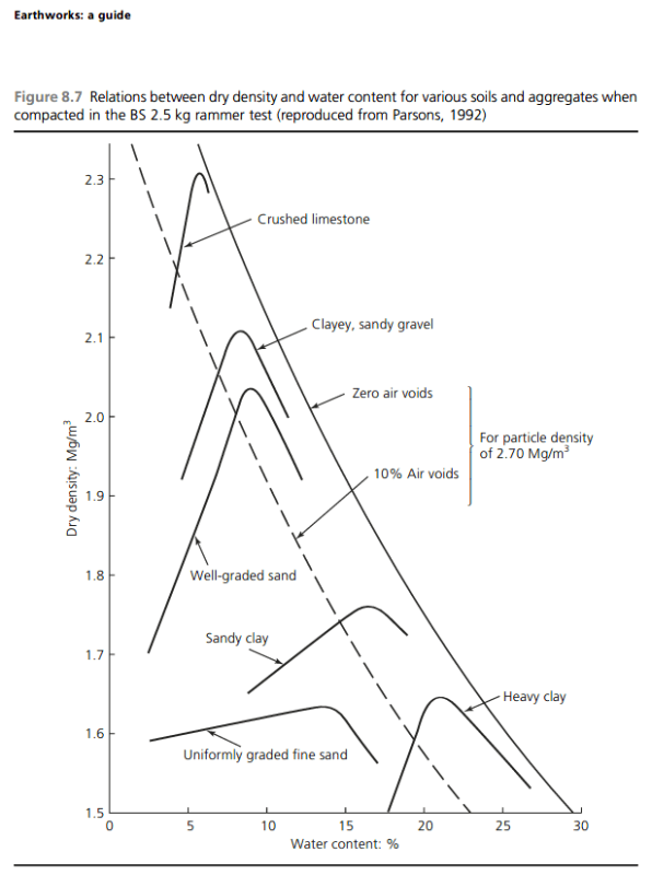

Hi all,
I am working on a project where there is a debate as to how the material was QA/QC'd to 90% compaction (standard proctor), however after settlement of some infrastructural, the compaction level is ~80%. The material is well graded sand with trace fine gravel.
One theory being floated around is that the material has a very bell shaped OMC/MDD curve. Someone has proposed that the material was compacted to 90% however as there were rainfall events / drying events, the moisture content has changed. As the moisture content changes, the density also changes. Refer to below sketch, we have an OMC/MDD line similar to line 1 which is sensitive to changes in MC.
I dont buy it to be honest. I argued that the purpose to the OMC/MDD curve is on moisture content during construction, ideally you are at OMC +/-2% (or whatever your spec says), if you are too wet or too dry you will likely find it difficult to achieve 90%MDD.

Think well graded sand should have a pretty flat curve and not sensitive to normal mc changes. NMC 5 to 8%?
Not sure you could place and roll at 14%.

Maxim22 - wouldnt a well graded material have a bell shaped OMC/MDD curve? Refer to screen shot below from Nowak - Guide to Earthworks. I havent seen our OMC/MDD curves yet, my sketch above (and reference to 14% and %) was theoretical to illustrate that a reduction or increase in moisture content of a material that has already been placed should not change its current density. When I have OMC/MDD curves i will post them.

Too sleepy in this office, its my mistake the bell shape curve is correct. Geologist confused well graded with well sorted.

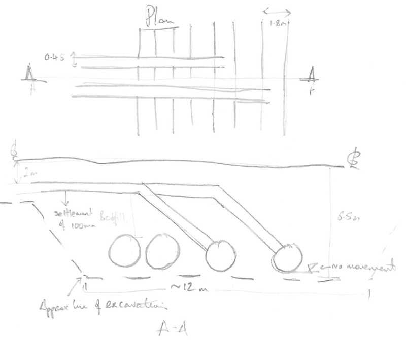

An update.
The settlement (100mm)is within pipes that connect to the main line as shown below. Some cracking has occurred and was noticed during filling, the pipes were never operational. There would have been some areas where water was leaking which would have worsened the situation. However, there are areas where pipes have not cracked / leaked and settlement has still occurred.
The degree of compaction required was 90% SPD, however the new OMC/DD test results are for modified so 80% MPD is a little closer to 90%SPD. Regardless of this there is still the issue as to why the pipes have settled.
From reviewing additional information I now understand that the connecting pipes are supported on backfilled material which was placed as bedding and backfill for two underlying large diameter pipes. The backfill material is site won Sand with silt. Coefficient of uniformity (Cu) is between 3-4, so the material is uniformly/poorly graded, so not good backfill material.

The connection pipes were installed prior to backfilling, these are rigid pipes that are spanning unsupported from the excavation cut (left hand side) over the adjacent pipes and into the main lines. As they were in place during backfilling of the pipes beneath, compaction beneath the connection pipes would have been very difficult due to the access limitations. Also, compaction may have been reduced/limited over the underlying pipes as a precautionary measure to reduce the risk of damage. I bet the QA/QC field density testing was undertaken at the areas which received the best compaction i.e. between the main lines or adjacent to the edges where there are no pipes beneath. No QA/QC testing would have shown the loose material directly beneath the connection pipes.
