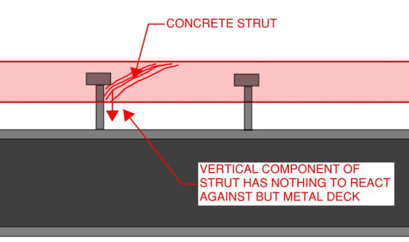

That arrangement shown in the photo doesn't work and wouldn't be acceptable for a composite beam. Not allowed by AISC and would, in my view, negate any composite behavior to a major extent.
The decking should be split and opened up to form a concrete haunch down to the top flange of the beam per what EZBuilding says and per AISC Section I3.2c.3 (AISC 360-16)

The sketches below just show the mechanics underpinning everybody's concern with this when composite action is required.

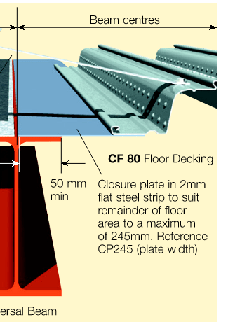

Cut the deck out so the concrete can get to the top of the flange. Yes it will require some fussing with sheet metal closures.

Never ever seen that before, usual practice round here is to stop and start the deck either side of a primary beam (girder in american speak), and if required finish off with some flat sheet metal attached to the deck and beam flange to close the gap. Kind of like illustrated below:-
Deck might not even be sitting on the beam flange on one side or both. You have to ask yourself if the beam design relied on full lateral restraint from the deck connections (i.e. designed to the full plastic moment capacity of the beam with no effects of lateral torsional buckling), if it did and the secondary beams were spaced far apart then this arrangement may also impact on the primary beam strength, because deck might span several meters? So instead of beam being restrained at nominally the stud centers, now the effective length could be substantially longer being the length between the secondary beams....
Much easier to do it the way you've shown, so that might be the answer as to why it was done that way....
