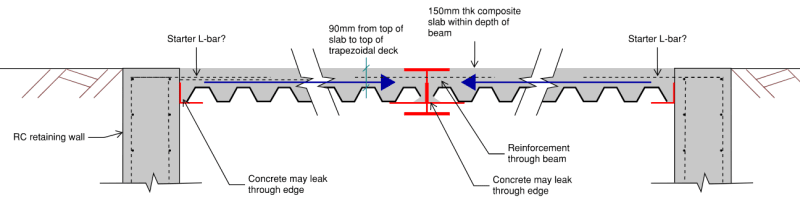

I am using a composite slab within the depth of a steel beam supported on angles but I am concerned if this will be sufficient to provide good diaphragm action. If the slab is fully within the depth of the beam would providing either shear studs or rebar welded to the webs be sufficient to provide the diaprhagm action? For the internal beams I am proposing to have rebar through the webs to connect the slabs on each side. I could extend the slab above the top flange of the beam and have the rebar continuous over but it would be preferable to keep it within the depth of the beam for the Architectural requirements. I have sketched some details of the options below:
If you want composite beams, raise the slab and pass the reinforcement above the steels & provide studs. Sketch #2.
The first sketch with welded reinforcement + threaded bars is not clear to me.

Thanks for the reply. I am not designing the beams as composite, I was specifically asking about the diaphragm action of a slab within the depth of the beam. In my case I am actually using the slab to prop basement retaining walls but am also interested in the detailing for an edge beam / metal deck slab. The first sketch showing reinforcement through the beam web or shear studs shot fired to the angle are not intended to generate composite action but to ensure a good diaphragm connection. Are you saying that these shear studs / reinforcement are not required for the diaphragm action?

It is hard to say using my imagination but: the axial force in the floor ( say 1/2 the retaining force /m) * floor span between beams , should be transfered as longitudinal shear along the steel beams. If you have the transfer length required (which you might) you don't need the studs. But if you don't, then you'd like to add them - I'd put them preferably on the web of the steel beam, if you have the tolerance.
I am just trying to ensure the force is transferred across the ground floor slab to the opposite retaining wall so that it is in equilibrium. I don't think I need to have shear studs on the web for this but am more concerned with transferring the compression force through the slab to beam junctions especially if I have the deck parallel to the beam. In this case, the concrete could leak at the junction as the gap may not be sealed completely and therefore the concrete may not be properly compacted.

I am designing the retaining walls as being propped by the ground floor slab.
Is the length of the retaining walls really that short that it's advantageous to run a beam longitudinally between them, rather than running beams across from one retaining wall to the other?
Even if that is the case, your diagram shows the steel decking/form pans oriented in the wrong direction to span from the retaining walls to the steel beam.
Anyway, with the way you have the slab, beam and retaining walls shown, you don't need to connect the slabs through or with the beam. The slabs on each side are pushing against each other with the steel beam in between. The only loads would be horizontal compression and the vertical shear due to the weight of the slabs. If the bottom of the slab isn't supported directly by the bottom flange of the beam, then all you need is a spacer to take up the difference. I'm not seeing the necessity for reinforcement through the beam, shear studs to connect the beam to the slabs, or any other attachment that ties the left and right slabs together.
I am not concerned with the span of the decking, only the ability to transfer the compression force through the beam. The slab is forming the ground floor over the basement and will need to transfer the force both parallel and perpendicular to the span of the decking. My main concern is if the concrete at the junction leaks due the decking not being tight to the beam and therefore has voids / weakness around the edges.

Will there be leakage? I doubt it, builders provide end caps at the edge gaps. Looks like that: Link
The only thing that could bother me is having earth pressures at rest on one side (K0) and active earth pressures on the opposite side (Ka). Then you would have the difference in force taken by the rigid beam as bending around the weak axis. Combined with the bending around the major axis. Could concrete separate from the beam in this case? The answer is no because the slab is always being compressed from everywhere. I don't believe it would deflect that much.
Which is why a couple of studs on the web of the beam would take the headache away. Alternatively raise the floor (sketch #1)
