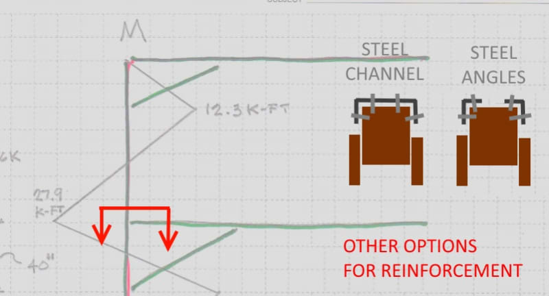

I have a continuous timber frame column with knee braces at 2 levels. At the lower level, the bending in the column results in a horizontal shear stress overload. I have maxed out the wood sizes available to me. So I came up with an idea to reinforce the column for shear by adding steel bolts across the neutral axis of the column to take the excess shear. Am I crazy? Do my calculations make sense?
I have attached 1 sheet of hand calcs with moment and shear diagrams and the column section used. The wood is Select Structural Doug Fir. The 2nd Floor Beam has a high tensile load on the column and the knee brace below has a high compressive load on the column. I will be slipping a 1/4" plate between the outer plies of the column and the heavy timber and using a number of 3/4" bolts to attach the beam and brace to the column.

The bolts through the column timber are perpendicular and pass through the neutral axis of the column. The idea is the bolts cross the horizontal shear plane to pick up the shear that the wood can't handle. This is somewhat analogous to shear studs connecting a steel beam to a concrete slab to make a composite section. The difference here is the wood has a relatively weak horizontal plane (neutral axis) that gets reinforced with bolts. The bolts connect the two "halves" of the column defined by the neutral axis.

To answer the question about the purpose or function of the bolts:
When a wood beam is overloaded in shear, the beam will split horizontally through the neutral axis. In a rectangular section, this occurs at the center. The lateral longitudinal force in each half of the beam is called the "horizontal shear" force. When the beam splits horizontally, you now have 2 beams, one resting on top of another.
If we were bolting two separate pieces of wood together in a tension connection, the bolts would be loaded in single shear. The tension is each member is equal and in the opposite direction. In this case, the "tension" or horizontal shear is partially resisted by the wood fibers up to 170 psi. The remaining lateral force on each side of the neutral axis is resisted by the bolts in single shear that prevents the beam from splitting into two halves.
My original post was asking the question, can the steel bolts share the load with the wood fibers along the neutral axis to resist horizontal shear? the next question, can the number of bolts required be determined as shown in my calculations?
I hope this clarifies everything. Thanks everyone for your comments and suggestions so far.

- Given slip etc, you'll have to fail the wood in shear before engaging the bolts. So it really the capacity of the wood or the bolts but not both acting in concert.
- Again because of slip, by the time that you'd fully engage the bolts, I'd expect this part of the your structure to be in ruin.
Wood members can and are reinforced using modern wood screw technology, typically installed at an angle. Stuff like this: Link. I think they even have some decent youtube vids on shear reinforcement. So there's that. In this particular instance, however, my feel is that you should interpret your difficulties as indicating that this is simply not a great system to begin with. To make knee bracing calc out for systems with any serious gravity loading, you've really got to:

Could you just use a glulam column instead of dealing with this reinforcing business? A 24F-V8 DF glulam has a shear capacity of 265 psi which would meet your requirements. I feel like these level of loads require some sort of engineered lumber. A PSL column would work also.
What about just reinforcing what you have? Do you think something like this would be acceptable visually?
