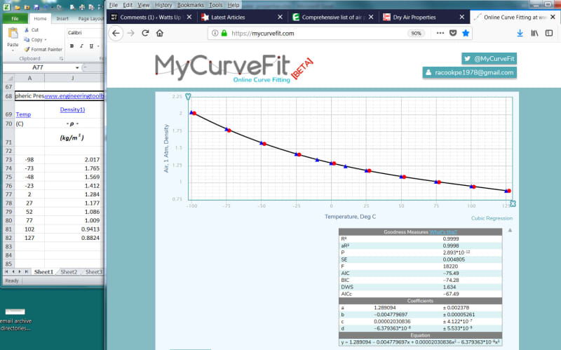

I used this table from EngineeringToolbox site, then developed 10 "best-fit" 2 or 3 order polynomials for each thermodynamic property from -73 C to +50 deg C. (But I was not interested in any higher temperatures.)
My spreadsheet read the specific temperature of each case, then calculated the thermo property (density, heat coef, resistance, viscosity, or whatever) for that specific temperature.
Caution! Few of the properties are even "near-linear" at even a limited temperature span near 0.0 C, so I did have to use best-fit polynomials for every case. Assuming a simple constant value across any but the smallest temperature range is even worse.

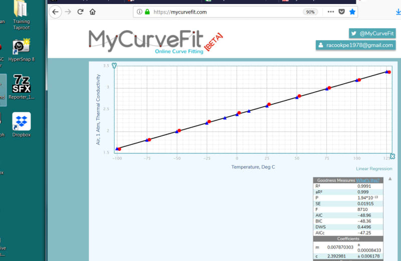

But the Thermal Conductivity over the same temperature range appears linear:
y = 0.007870303*T + 2.392981

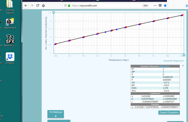

But a quadratic polynominal fits better:
y = 2.411626 + 0.007979624*T - 0.000003769697*T^2
Density is also a little better match as a 3rd order polynomial than a quadratic:
y = 1.289094 - 0.004779697*T + 0.00002030836*T^2 - 6.379363e-8*T^3
