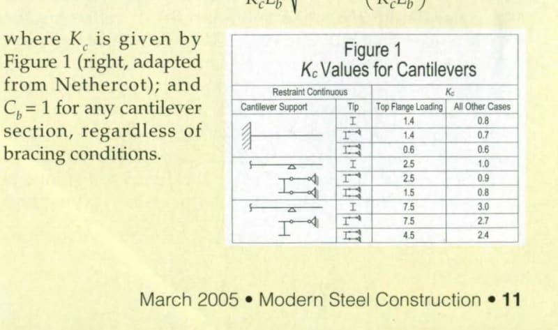

For me, it would go like this:
Detailing
- steel columns.
- Four bolts to cap plate and stiffener pairs over column such that the beam can plausibly be considered rotationally braced at the columns (effectively both top and bottom flange restraint at this locations.
- No discrete bracing unless that is somehow aesthetically tolerable.
Center Span
- Lb = distance between columns. No inflection point bracing.
- Cb = Whatever makes sense for the moment diagram.
Cantilever Span(s)
- Kc = 2.5 per the clip below.
- Cb = 1.0
I agree with the KootK method. Brace the beam at each column using cap plate and stiffeners, then select a beam which can carry the load with an unbraced length of 28'. Makes sense.
