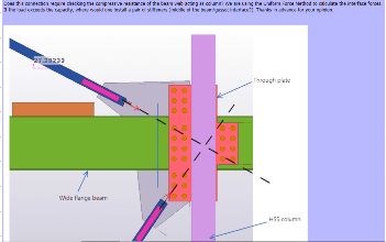

Does this connection require checking the compressive resistance of the beam web acting as column? We are using the Uniform Force Method to calculate the interface forces. If the load exceeds the capacity, where would one install a pair of stiffeners (middle of the beam/gusset interface?). Thanks in advance for your opinion.
