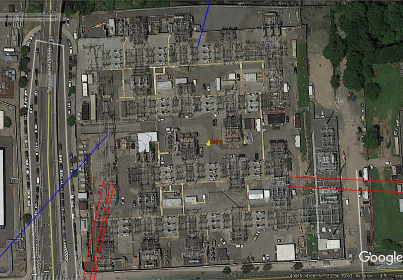

FWIW, there is currently another massive outage (that was about 3 times larger customer wise) being investigated that took place on August 7 2020 but was given limited coverage:
Not sure this outage played any role in the penalties decision.
FWIW, as best as I can gather roughly same thing took place as with West 49th st. At least half a dozen or more 345kv positions cleared at Rainy Substation dropping 5 138kv feeders which supply the East 75th st and West 110th st substations. A total of 15 138-13.8kv 65MVA transformers were probably de-energized.
Transmission feeds to 75th and 110th:
Rainy:
