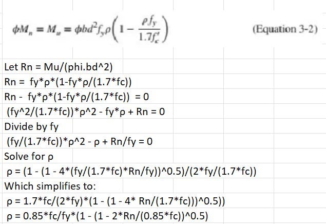

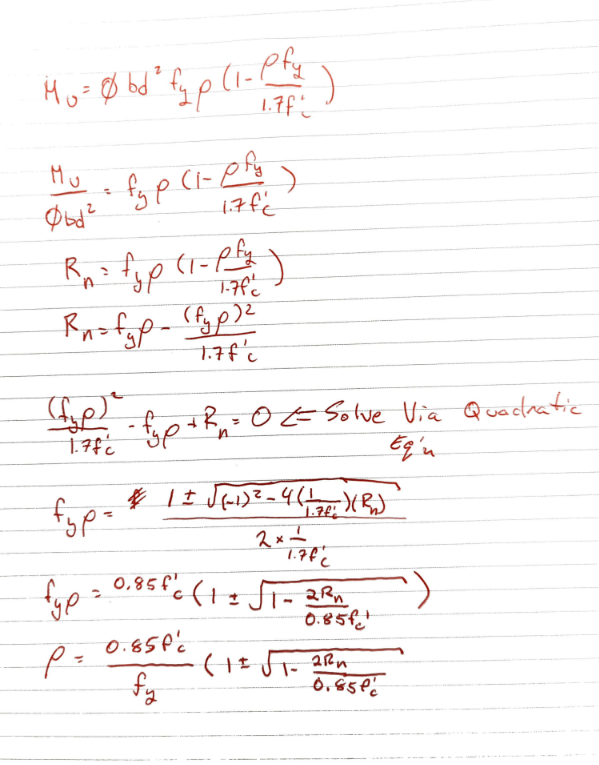

Hello, I am having a little trouble deriving the percentage of steel reinforcement for a beam using rho and Rn (Flexural Resistance Factor). The results are given in Design of Reinforced Concrete by McCormac & Brown - Equation (3-3), attached for reference. I however have not been able to make the correlation. Does anyone have a reference illustrating the steps to get here? I believe the Whitney Stress block --> a = (As/ 0.85 f'c)*(As/b*d)* d can be helpful but I cannot find the result.
Similarly are the any other helpful "cheat sheets" / sources showing derivations of useful concrete equations like this? Thank you in advance.

Did you try the following?
1. Eq. 3-2: divide both sides by phi*b*d^2
2. Eq. 3-2: make the left side Rn
3. Quadratic formula to get rho.
4. simplify
Hello 271828 and thank you so far. I am with you there to Step #: 4. The simplification and cancelling out of variables is what I was missing. Perhaps I should have been clearer, but that's what I intend on looking for, a proof if you will.
For reasonable amounts of reinforcing... assume moment arm is 0.9 d and calculate the As, calculate the depth of the compression block, and then use this value to determing the new compression block moment arm. It converges very quickly to the 'exact' value. ;[gen rev]
See attached. Then discard the second solution because it requires negative steel, which is apparently still not available in the industry.

See attached........
