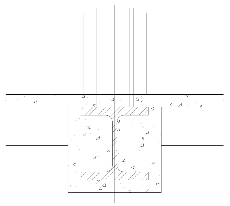

Good Morning all,
Please help me with the image bellow. The engineer Is proposing a steel column HEA260 at "Pórtico4". The Columns P5, P6, P7, P23, P24 and P9 are ALL CR columns with 250x250mm. As a constructer I have a great deal of difficulty accepting this solution but the engineer was quite insulting and said that there is no problem with this solution. I requested construction details that he didn't provide so far. I do not like to question the technical knowledge of the engineering but I've never done or seen something like that in 20 years of construction. My particular concern is with the columns P23 and P24 with no support underneath and the connection of the steel beam to the edge columns P5 and P9. This beam is at the second floor residential area with a flat concrete roof above. Could someone help me clarify this problem and probably elaborate a response to the engineer? Thank you very much for all your help.
Just to clarify, my main issue is not in having two floating columns mid span of the beam. My main issue is that those columns are RC columns on top of a steel beam. It looks like an odd hybrid solution that could be avoided...

I believe that all that makes sense. Indeed the focal reason is the ceiling height. But the way he draws the steel beam not anchored to the columns or concrete wall. It interrupts the rc columns and new columns start from there. In theory all makes sense, but I've never seen a real world case where this solution is applied. And I've searched all over the internet and not a single photo or a construction detail with that same scenario. And that made worry about the solution.
You last message makes it seem like you're concerned at locations where there is a concrete column above and below the beam at the same spot where it appears the current design has the beam framing continuous through and the column stopping and starting, can you confirm?
If so, I agree with your concerns. Those would normally be done with continuous columns and cast in or bolted on weld plates for the beams to frame into.
@Jayrod12 yes that's one of my concerns. Continuous columns make greater sense. Have you ever seen a real world example similar with the solution presented? Is it feasable?

Is there a concrete slab cast over the HE beams? How are the columns connected? Dowels into the slab or dowels welded to the HE beams. Unless I'm missing something, I don't see a problem except maybe at P23 and P24 (I thought there was a beam... maybe joists) where there may not be enough lateral support, except as provided by the 'joists?'. At the other columns there appears to be adequate torsional restraint offered by the connecting beam. A bit of a problem, if a slab, might the proper column placing location of the columns above.
@dik the He beam is encased on a ribbed slab. Those are not joists. About the connections I don't know. I'm still way ting for the details to bring some light into this...
If those are ribs... then I'd be less concerned about the stability of the beam column supports. Is the ribbed slab 50mm thick with the 'beam/joist' component 150mm?
As far as details go, I'd just weld rebar dowels to the steel beam, and extend them into the column. This is not tricky construction.

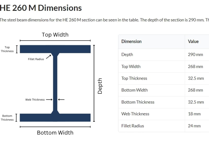

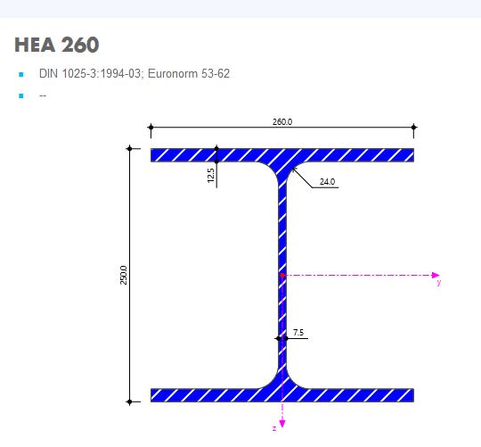

Beam has a 260mm wide flange. Maybe he intends to weld dowels on the beam, lapping with the column steel. Very unusual detail.
Something like... I used a 260M... I guess it's different...
not at all, done this with concrete often occasionally. There isn't enough concrete thickness to develop a hook...<Sarky> Might consider tapping threading the rebar and bolting it through the beam? </Sarky> [ponder]
Is the beam to be encased in concrete as dik shows?? Depth to span ratio is 34.6; hopefully the column loads are not too big; looks like a large uplift at Column P6.
