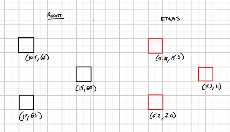

Dynamo would be any option the process would be:
1 determine a way to map etabs/ram columns to the revit columns
2 dump the design summaries to a spreadsheet
3 using dynamo read in the design data and populate the appropriate parameters in the associated column
step 1 is the hardest part as the coordinate systems are usually different and etabs/Ram ID's may change with some modeling operations.

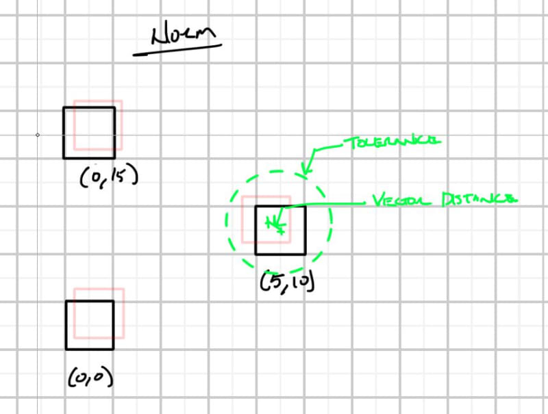

exactly, I've had decent luck in the past by normalizing the column x,y coordinates based on a common column and using a vectored distance tolerance to account for round off or modelling errors.

Essentially summing the column reactions sequentially from each floor's ram concept model using location coordinates to map columns. Definitely build in a radial tolerance though.
