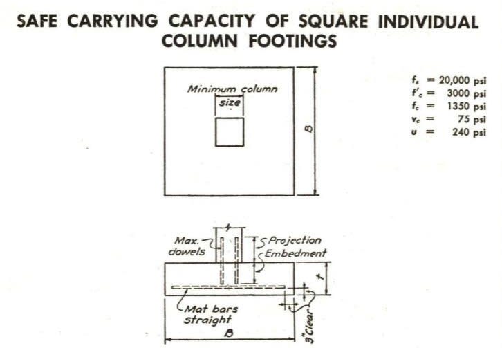

Every footing detail I've ever seen has 3" cover. Bottom and side. Look at CRSI tables, too.
CRSI 1957 from Archive.org
