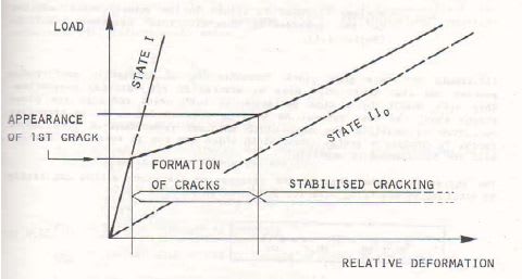

Pls look to the following figure to get the concept. The transition from the uncracked state (I) to the cracked state (II) does occur gradually. From the appearance of the first crack, realistically, a parabolic curve can be followed which approaches the line for the cracked state (II).
