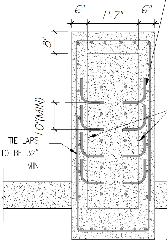

Hi there, I am going over a past problem and would like some clarity.
I recently designed a concrete jacket.
To simplify the problem. The top of an existing column was in poor condition. I have a lateral load applied to the column at the top (cantilever). I want to provide a transfer mechanism to transfer this load at the top to some of the sound concrete below. I want to figure out how to determine the spacing of the shear dowels I need to transfer the load.
See below (the blue square around the black square is the RC jacket)
The issue that I am realising is that because the neutral axis of the concrete jacket is the same as the neutral axis of the existing concrete, there wouldn’t be any shear flow in that location. So I don't think that I can calculate it like a normal shear flow problem.
I was looking into what was done for flitch beams as it seems like a similar problem and there wasn’t much guidance on the spacing when you have a concentrated load (it’s quite straightforward for a UDL), one document I was reading was pretty much saying try to have the dowels as close to the concentrated load as possible. Although this doesn't tell me much about the spacing.
I know the number of dowels required to take the load (18) but can’t have them all congested at the exact location of the load as there would be too many.
Does anyone have any advice or guidance for situations like this?

1) there probably will be shear flow if you consider the concrete section to be flexurally cracked.
2) If your strategy is to truly bypass the upper concrete, you can probably transmit the shear and moment to the concrete below by conceptualizing your wrap as a pair of opposing u-straps. Under that model, the demand in the anchors would be pretty nominal.

To provide some more clarity, the damaged portion at the top of the existing column will be removed and a new portion poured. The new portion will be connected to the existing with vertical dowels and an RC jacket will be merged with this. The total height of the repair will be about 8'. With the top 4' being new concrete doweled into the existing and the bottom 4' being the new RC jacket around the existing. The reinforcement will be continuous between the jacket and new concrete at the top (apart from the side dowels into the existing, these would just be on the bottom 4').
The cross-section shown below may be able to clarify what I stated above a bit better and will show what my thoughts are for the repair.
My thoughts for the repair as a whole is that jacket will confine the system. With the confinement preventing concrete breakout etc. When you say u straps, do you mean like the ties I have shown? Would you be able to elaborate a bit more on the u-strap model? I think understanding this would be helpful as the jacket confinement reinforcement used was based on the recommended minimums (T12's at 10" ties, and enough vertical bars to satisfy 0.8% of the jacket area).
@Ron yes that is true but to mimic this monolithic shear interface, I would still need to know how many dowels are needed to achieve this. Normally I would think that it is done by shear flow calculations. I have specified surface roughening to be done before pouring the RC jacket, which will also improve the monolithic behaviour but I didn't want to just rely solely on this because I don't know how to quantify if a roughened surface alone would be enough to achieve monolithic behaviour? This is why I was also looking to include the side dowels.
1) I did a poor job of reading your initial post and, originally, thought that we were discussing a steel jacket. That said, I feel that my original comments still apply.
2) Based on what you've told us to date, I don't feel that you need the jacket. Confinement approaches are usually used for members with heavy axial loads or flexural demands that will take the member into the elastic range. Your situation doesn't sound like either of those conditions.
3) As far as shear flow and dowels go, I feel that your best analog will be the ACI 318 provisions that deal with adding second pour, composite toppings to concrete beams. The principles involved are nearly identical to what you're seeking to do. Realistically though, I don't feel that composite flexural behavior is a reasonable goal to strive for given your proportions on this thing. The flexural stresses may not have sufficient "time & space" over which to rearrange themselves in that fashion.

4) In the world of street lamp posts, sometimes a flexural splice is made by sleeving a larger diameter, tapered pipe section over top of a smaller diameter one. Imagine the likely design model for that connection and then extend it to your situation.
