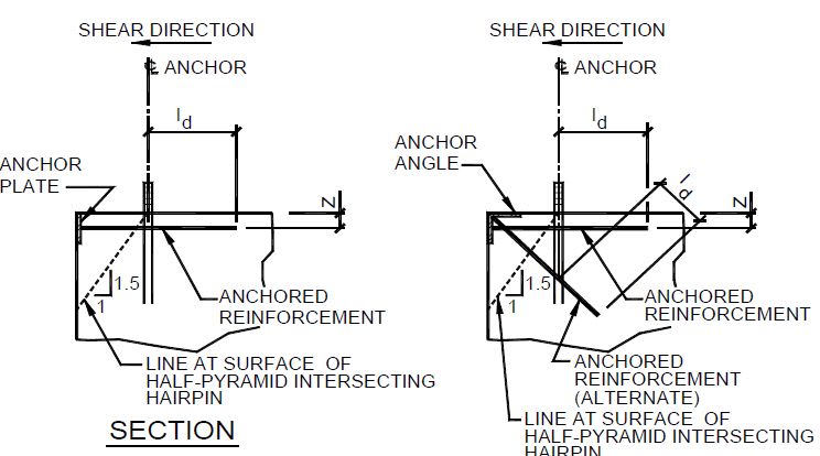

The factored shear load of 86.6 kips is substantial amount.. The sketch which you have posted the break out zones implies that the transfer of shear is considered with two anchor bolts at left side...

- Finally, you may consider to provide anchor angle or anchor plate similar to the following sketch ( excerpt from PIP STE05121 )
I hope my post answers to your questions.

I would much prefer to resolve the shear at the column stand in a very distinct / unmistakable way (i.e. not slab embedments). The solution phamENG suggests might work as would pilasters of sorts below the SOG depth or grade beams acting as tension ties, etc. I actually like your W-flange idea given the distance between the ties (whatever they end up being) and the column/pilaster interface. But I might (A) bolt it to the footing and (B) extend the footing / pilaster towards the inside of the building and encase a gusset / studs or rods extending off the W-section into a concrete mass. You only need roughly 16m3 of concrete (less amount already contained in your footing which I don't know) / column which isn't that much. Maybe an extra $1000 - $2000/ column?
