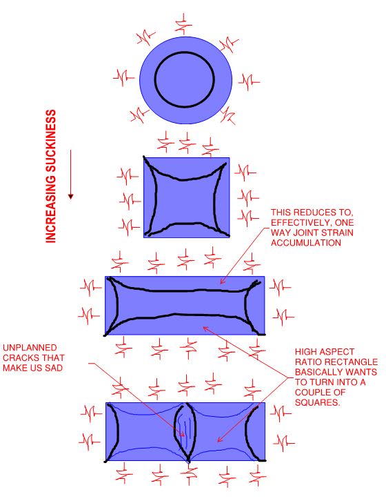

I'm wondering what's the theory behind limiting the length to width ratio between joints in a slab on grade?
It's widely known that the ratio of panel length to width shouldn't exceed 1.5. Panels with excessive length to width ratios are likely to crack at the mid-panel point or at some other location between joints. But from where this number came from?

As with most things about slabs on grade, it is mostly experience rather than theory.
There have been some attempts to quantify it and use it to define reinforcement requirements. They take into account typical drying shrinkage stresses and strains in the panel, coefficient of friction between the concrete and vapor barrier or soil, etc. Even with all that, there are plenty of unpredictable variables and it still falls back on the empirical experience that hokie is talking about.
I normally use about 1:1.5 as a maximum.

That theory is basically just the theory of elasticity in the context of shrinkage induced tensile strain. When panel aspect ratios drift too far from unity, the ability of the the jointing to absorb strain around the perimeter loses it's two way character and effectively become a less efficient one way system.
I like to imagine three equal area trampolines where the mat is a bit old and crusty and I'm trying to prevent a tear. You have to imagine stiff diaphragm shear restraint around the perimeter to make the analogy work. No doubt the 1.50 value that we use is very approximate and experience based rather than calculated.
It’s an empirical rule of thumb.
