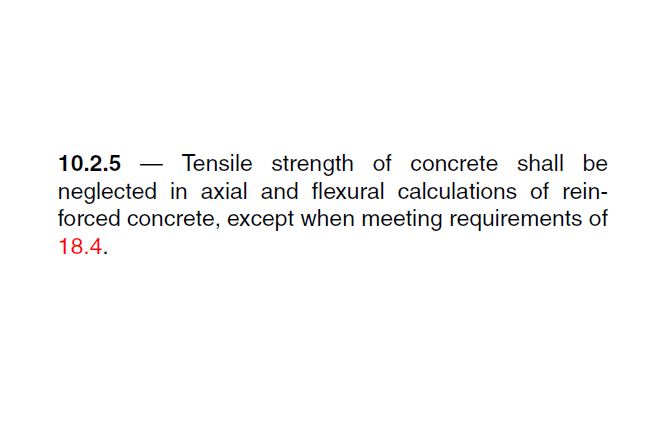

Thanks for the info rapt. I have never done any prestressed design. I was referring to the following 2005 ACI statement and section 18.4 is about serviceability of prestressing as you stated.
The difference is between allowing tension to exist in the concrete (which is allowed), and counting on the concrete to provide tensile resistance (which is not allowed by any codes I'm familiar with).
