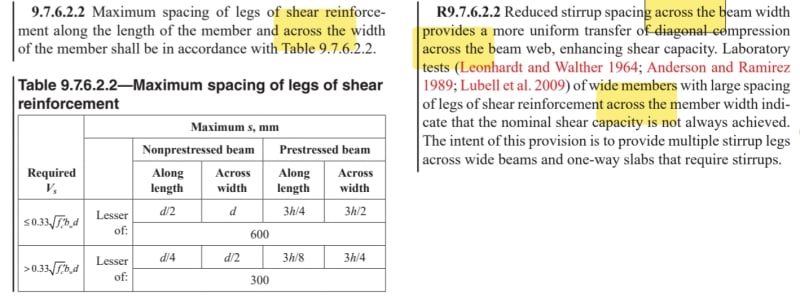

I'd disagree with hturkuk, and say it depends on the width of your beam relative to the effective depth. You need links for shear to be relatively evenly spaced across the cross section in wider shallower beams otherwise you risk longitudinal cracks along the section due to the internal compression struts acting across the cross section being very shallow to get to the edge of the members, resulting in tension across the tension face and increasing the liklihood of the beam face cracking along the beam axis.
Codes also have requirements regarding spacing across the section for main bars and every second bar requiring restraint for confinement and antibuckling in beams. I'm unsure what ACI318 exactly has to say on the matter (which I know is what you're asking). But it's common practice and a code requirement round these parts, especially if you're actually utilising compression reinforcement for strength (for example if it is actually in compression when you analyse the cross section) for non seismic cases, and always for seismic where loss of cover concrete might occur under cyclic loading where you really need the confinement.
I've seen some people say, we'll I don't technically need the compression reinforcement (for strength), so I don't need to restrain it. But in my opinion if you've provided it, it may be in compression so needs the restraint required by codes if it actually is.
Clause 9.7.6.2.2 in ACI318-19 is what I'm referring to at the start of previous reply. You need to satisfy these spacings across the section width.
I agree with you.. it depends on the width of beam relative to the depth .. Doubling the stirrup is also necessary when the stirrup spacing along the length is less than 3 in. for placing the concrete. The sketch that OP provided implies the aspect ratio b/h around 1.5 ..

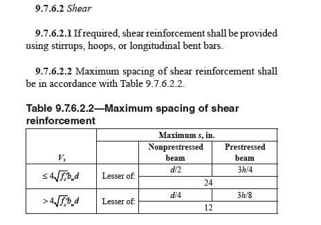

I have ACI 318 -14 and i copy and pasted the relevant section at below;
Apparently this item revised at ACI 318 -19.
If the OP can clarify the size of the beam , nominal shear strength provided by shear reinforcement (Vs), we can see the max. spacing requirement across the width acc. to ACI 318 -19.

Those ACI provisions I posted are for all beams and apply throughout the entire length of the beam. Hanger reinforcement requirements/detailing where more onerous may govern locally at intersecting beams and so forth.
The table I posted is the minimum spacing requirements only, other requirements such as shear strength, confinement, antibuckling and minimum shear reinforcement provisions may all govern depending on the situation. As a designer, you should obviously be checking all provisions as part of the design.
In NZ (my local concrete code), there is a limit for spacing across the cross section as noted below for applying what is essentially the same intent as the ACI provision.
You will note these provisions are more onerous than ACI, requiring d/2 spacing across the section, not d as for ACI low shear requirement. Under higher shear >>0.33*b_w*d*(f'c)^0.5, half the spacing applies, so d/4, but no less than 200mm as noted below.

I did not see any clause at ACI 318-14 but, the commentary R 9.7.6.2.2 at the excerpt which Mr.AGENT666 posted provides the concept..My personnel experience , i provided double stirrups for wide beams ( ribbed slab beams etc ) and when the stirrup spacing along the length is less than 3 in. for placing the concrete.

Not sure to be honest, we've had it in our standard since 2006, and it's the first time I've noticed it in ACI318-19. There's quite a lot of recommendations that have flowed through from NZ code into ACI318 based on our recent learnings in major seismic events and associated research projects, but these particular requirements predated the changes following 2010/2011 Christchurch earthquake sequences.
