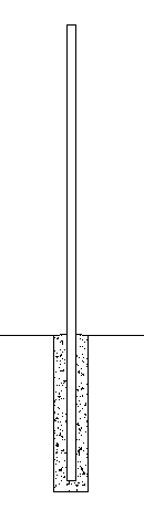

They are for two different types of foundation elements.
ASABE EP486 is for shallow post footings - large hole, spread footing at the bottom of the hole, post resting on or attached to footing, and the hole backfilled and compacted around the post. Big signs, pole barns, etc.. Can handle large axial gravity loads, plus uplift forces from overturning movements - complicated calculations. Don't see any restrictions on how deep they can be.
IBC 1807.3 is for embeded posts - a smaller hole, post surrounded by concrete or compacted fill for fences, flagpoles, sign posts, decks, etc. Uplift only resisted by the dead load. Simple calculations. Only valid for up to 12' deep footings. In the commentary, they say there are more complicated methods, but they end up with similar results. For simple projects typically not be worth the extra effort of the EP486 design procedure, but no reason you couldn't use it for both types of foundations.
Embedded post per IBC 1807.3 ------------------- Shallow post foundation example
