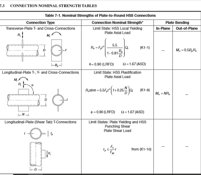

Over a wide range of connections tested by Sherman (1995, 1996), only one limit state was identified for the RHS column. This was a punching shear failure related to end rotation of the beam when a thick shear plate was joined to a relatively thin-walled RHS. Two connections failed when the shear plate pulled out from the RHS wall at the top of the plate around the perimeter of the welds. A simple criterion to avoid this failure mode is to ensure that the tension resistance of the plate under axial load (per unit plate length) is less than the shear resistance of the RHS wall along two planes (per unit plate length). Thus (Sherman 1995, AISC 1997), ø1 f,p,y tp · (unit length) < 2 ø2 (0.60fc,u) tc · (unit length)
In the above inequality the left hand side, the tensile strength of the plate, is multiplied (for limit states design) by a resistance factor of ø1 = 0.9 for yielding. The right hand side of the inequality, the shear strength of the RHS wall, (for which the ultimate shear stress is taken to be 0.6 of the ultimate tensile stress), is multiplied by a resistance factor of ø2 = 0.75 for punching shear failure (AISC 1997).
Hence tp < (fc,u/fp,y) tc
