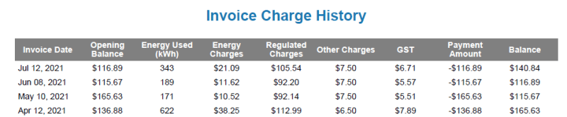

Here is a screen shot of some invoices:

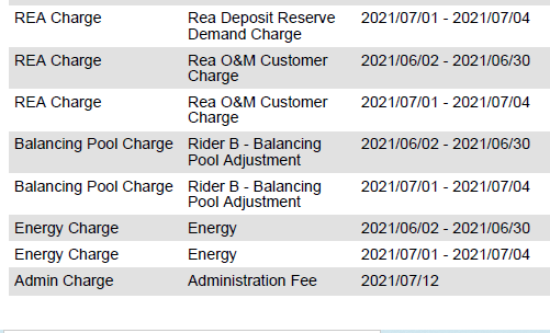

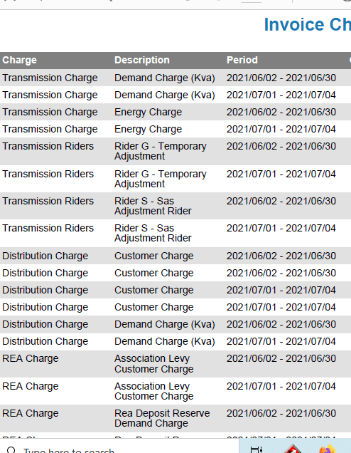

Here are some of our monthly charges. There was a slight rate adjustment on one of the charges so all the entries are doubled, once for the days at each rate. There is an entry for 29 days and an entry for 4 days.
Charges continued:

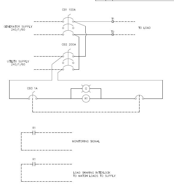

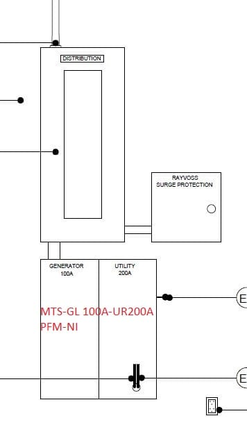

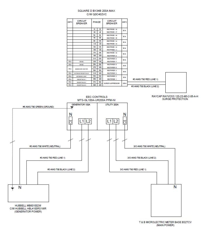

Hi Gurus,
I would appreciate comments on the attached SLD and layout photos . Instead of having interlock kits install on the 200A distribution Panel, this 'MTS' seem to do the job with its own built-in interlock. From the SLD, it seemed to have power monitoring and 'load sharing Interlock" capabilities. There isnt a dedicated breaker in the panel or subpanel for the gen supply either. It beats me how one could prevent the generator from overloading without manually switching of some circuits in the 200A panel Panel. Which defeats the purpose of an MTS with an interlock in my opinion.
MTS as in manual transfer switch? If someone is present to throw the switch, they should be matching load to generation prior to making the transfer. Same with the main panel interlock proposed above.
The signal relay might be used to control loading, but I fail to see the point with a manual transfer.
It seems to me your "load sharing interlock" with it's description of "to match loads to supply" is designed to interlock certain loads from operating when on generator supply (actually when NOT utility supply available), whether by dropout contactors or electronic controls. I would have named this "load shedding contact" or the like, but YMMV.
