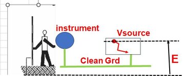

Can you please brief what will happen if the bonding/jumper is not provided between Instrumentation(Clean) and Main earth Grid??
TheClean Grounding not connected to Main Grounding.jpg Clean Grounding get the source potential with respect to Main Grounding
Possibly a fatality during a ground fault when two grounds at separate potentials are bridged by a human. See the graphic in the post above.
During a ground fault, heavy currents and the associated voltage drop may be present on the grounding conductors.
In the event that instruments were connected to different points on the grounding grid, and are separated by a voltage drop, the voltage difference between them may be dangerous and may interfere with the function of the instruments.
This condition may also interfere with the signal quality and accuracy, and cause mis-operation of the controlled equipment.
Best practice is to use a dedicated ground buss for all instruments, and then connect this bus to the main ground grid at one point, so that any touch potentials on instrument cases will be mitigated to a large extent and any voltage rise on the instrument grounds will be a common mode voltage that will not affect the function nor accuracy of the instrument signals.
It may be more correct to replace the terms "Clean Ground" and "Isolated Ground" with the term "Dedicated ground Bus".
