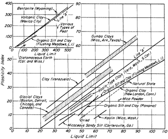

Both of these materials can swell when saturated, so your void ratio could exceed 1. You have not given enough information for us to know if your values are correct. They are higher than I would expect.
Bentonite is used a a borehole sealant for its swelling characteristics and has a plasticity index of greater than 100 and would be what I define as super plastic as high plastic just doesn't fully capture the properties.
