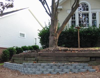

Okiryu - With the neighbor's permission, construct a gravity retaining wall in front of the existing wall. Fill the space between the walls with compacted soil as the gravity wall is built. The combination of the existing wall / compacted soil / new gravity wall should act as a single (very thick) wall. The segmental blocks are self-draining at all joints.
I did this for a 4' high existing, rotting wood retaining wall 13 years ago, using only the retail version of blocks. It continues to perform as expected without deflection. Note that there is a mature magnolia tree surcharge load on the wall. These photo show the existing wall and the gravity wall under construction. The gravity wall is full-height, the wooden wall is completely buried.
Edit: Deepest excavation, performed one block at a time: 8" deep, about 18" from the existing wall.
