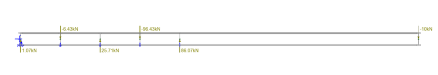

That makes complete sense if you supports are infinitely rigid which is presumably what you have modelled.
Fix your model use appropriate boundary conditions. ie; model in the actual stiffness of the supports or an estimate.
(We had a similar question last week where the user wasn't using appropriate boundary conditions. Though at least you've clearly caught the error and asking the question.)
INFINITELY RIGID:
SOME SUPPORT DEFLECTION (<1mm at all supports.)

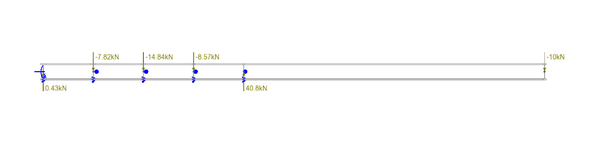

INFINITELY RIGID:

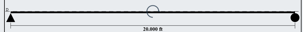

So if I ran some columns with outriggers moment connected off, say for a crane rail, and found that the outrigger deflected 3mm. When analyzing the crane beam, do I just play around with the kN/mm stiffness until my beam model has that support deflecting 3mm? Since the reaction changes depending on support stiffness (although not much as you have eluded to) is it an iterative process whereby you guess an initial stiffness, check support deflection and re-analyze or is there a more straightforward way.

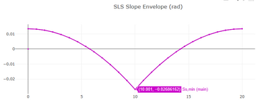

As an example lets assume that beyond the outrigger-column joint the column end conditions can be idealized as pinned and that the rigidity of the connection itself is not considered, then as an example:
20 ft tall W8x10 column
Outrigger located at mid height

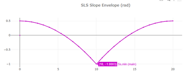

Applying and arbitrary moment of 100 ft-kips to column it yields a rotation at the load point of -0.02686162 rad.
Assuming linear-elastic material the moment needed to make the rotation equal to 1 rad = 100 ft-kips / 0.02686162 rad = 3722.783 ft-kips/rad
So if looking at the outrigger as an isolated cantilever beam you would assign a rotational spring stiffness of 3722.783 ft-kips/rad
You could also do a vertical spring which can be derived for the column by equating PL/AE = 1 in or ft depending on the unit consistency needed.

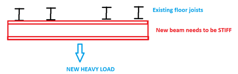

I have a such a scenario sitting on my to do list at the moment:
If you model that new beam on its own with rigid supports you will get reversing reaction as the beam is continue over the supports closest to the load. If instead you model it with springs for support or model in 3D the existing joists then you won't get reversing reactions. Instead you get load sharing between the 4 joists. Which is the intended purpose of this configuration.
