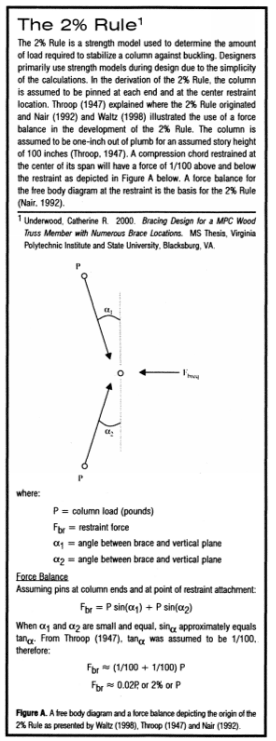

We've moved past this but, for interest's sake, the blurb below is one of the few places where I've found justification for the 2%. My records show that I picked this up from SRE and that the author was somebody by the name of Underwood.
Aren't the alpha angles 1/50 if it's 1 inch out of plumb over 100 inches?
