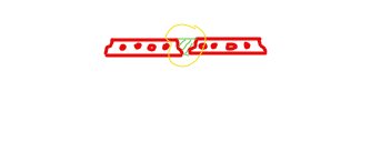

Hi Folks,
Have a floor (roof) slab diaphragm comprised of Hollowcore planks spanning onto precast beams,
5Bays of planks (onto 4 internal beams)
Where planks are supported onto the internal beams we have rebar in 2no. cores in each plank (2dia.16 bars) joining adjacent planks together (over the beams / tied in with protruding reinforcement from the top of the beams / all then concreted in)
Planks are tied into perimeter beams with U-bar stirrups coming out from 2no. cores in each plank - wrapped around lacers/longitudinal steel forming beams
We are placing no reinforcement in keyways, but they will be grouted up (nominal longitudinal shear transfer via grout to concrete)
We have no structural topping screed. Just a light-weight non-structural topping for roof substrate
Question - should we be placing continuous rebar in the keyways for diaphragm action?
What aspect of diaphragm action would you be intending to use those bars for? Obviously, they would not do anything for longitudinal shear transfer at the joints between planks. If you have dowels coming out of the beams and grouted into the keyways at the ends, those can be used for to transfer shear perpendicular to the planks at the plank ends. That said, if you've got rebar in the cores that performs the same function, I see no reason whey you would have to use keyway dowels in addition to that.
@KootK Totally agree with you. This has been the subject of debate with an external engineer who is insistent on their inclusion ....without justification "its a standard detail". I too don't see the need for them from a diaphragm action perspective, nor from a progressive collapse detailing requirement.
If you have other rebar, I'm of the same opinion as Koot. That being said, dowels from beams into the keyway is a common typical detail as they're easier to install and grout than directly into the cores.
