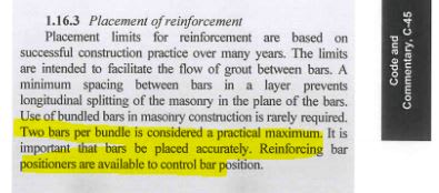

contractor wants to use 8" block and no bigger than #5 bars. as opposed to pilastering,butressing, etc..., I cant figure what would be wrong with bundling (2) #5 bars for the verticals, or (2),then (1) every other course staggered? thoughts? ready set go...
(edit- for clarity at request)
retaining wall pushing over the limits of what #5 bars on 8" centers can do in a block cmu retaining wall. how about (2) #5 at 8" o.c. vertical, a two bundle for the stem steel?

So the contractor doesn't want to build a wall that will stand up? That's his problem. Can you put a double #5 in an 8" block - possibly. Is it a good idea? No, not really. Mortar fins would have to be non-existent, splicing will be very difficult, grout will have to be very fine. There are a lot of ways to screw it up and the contractor already sounds like somebody who doesn't really care what the engineer has to say. Give him something difficult to build that will be hidden until structure falls down? Yea...he'll build it that way...
