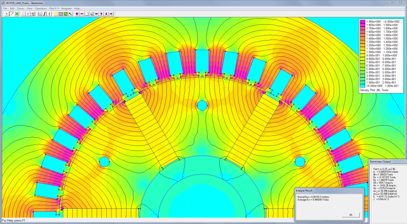

I am comparing two models that I have created in FEMM (Finite Element Magnetic Modeling). I am using this for lack of any other analytical tools to use that I know of - despite looking many times in many places. Book recommendations are still welcome!
The image below represents a model of the machine I have already built in the past - with some modifications based on a machine I am preparing to build soon.
I was previously told that I could improve the machine by using pole shoes or some other means to reduce the air gap. So I've modeled that, too:
It's probably hard to read. The legend is scaled from 0.0 to 2.0 Teslas. There are areas with peak flux about 1.9T. Another thing that is hard to see in the graphic is that a line has been drawn between one of the poles and the stator teeth, across which FEMM measures the gap flux.
Without pole shoes: mean air gap 0.060 inch, Flux=0.00141 Webers
With pole shoes: mean air gap 0.0385 inch, Flux=0.00138 Webers
So I'm confused now. The mean air gap without pole shoes is almost twice as large as with them. The flux should be much smaller. The same magnets and all other components are identical in the two models.
But it's just a computer model, and I don't deeply know how it works, so is this "GIGO"?
If I were to set aside FEMM for a better way to design this, what would that way be?
What analytical tools exist to help me solve this for myself?
Is there a "back of the envelope" calc?

It seems that you have very thick magnets compared to mechanical air gap. Magnetic air gap (which defines the flux) is the thickness of magnet plus mechanical air gap length (because mpermeability of magnets is almost the same than with air). Between those two cases, I assume that the magnetic air gap changes only very little (since it is mostly defined by magent thickness, which is constant) and therefore you don't see any big change in flux.
With pole-shoes, you will have also bigger pole-to-pole leakage flux (this can be seen in you flux-plots), which would explain the fact the the total flux is even smaller despite the smaller air gap.
As a side comment, if those pole-shoes are massive steel (not laminated), you might want to check you how much you will have eddy current losses generated on those due to slot harmonics. They can be surprisingly big, depending on the frequency
Have you considered using curved magnets instead (without pole-shoes)? This way you can also minimize the air gap length without using pole-shoes.

Permeability means how well the material conducts magnetic flux. Iron has very high permeability, meaning that it has very small "magnetic resistance". Permanent magnets have very low permeability (about the same than air), meaning that they conduct magnetic flux very poorly. This means that most of the magnetomotive-force from the magnets is consumed in creating the flux in the magnet itself, and physical air gap plays minor role
Magnetic air gap is the thickness of the magnet (0.5 inches) plus the physical air gap (0.06 inches) -->0.56 inches with your design without poles shoes. With the pole-shoe design, it becomes 0.54 inches. So you can see, that even though you have reduced the physical air gap length by one third, magnetic air gap changes only by about 4%. This is the theoretical change in air gap flux. But due to higher leakage, the actual flux is even lower with pole-shoe design
Regarding eddy-currents, the only way to calculate them anywhere near accurately is to use FEM software (I'm not sure is FEMM capable of that, I'm using commercial software myself).

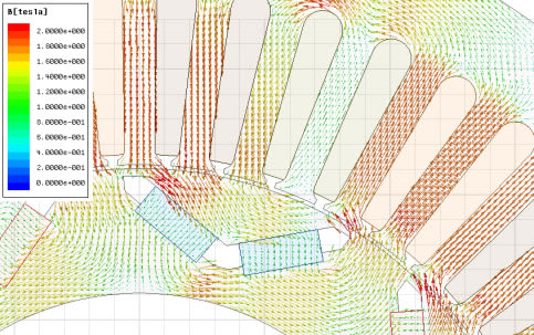

Speaking of ANSYS, here's a pic from their website. This looks like a more efficient use of magnets:

Thinner magnets would help.
The inward angle does help reduce leakage, but can cause some other issues.
There are other magnet/pole shape options depending on how much machining you want to do.

Just taking a guess from the image I stole posted above, it looks like the leakage flux between poles would re-direct to the stator tooth, depending on the tooth position and the amount of air gap. I plan to investigate with my (admittedly limited) tools.
A little bit more work made things come clear.
The magnets are driving the magnetic circuit, but they can be anywhere in the circuit. I didn't realize that you can literally think this way, much like the electric circuit must be complete for a current to flow. The coin dropped and I found a way to orient the magnet to make a strong field. The parts are easy to fabricate as flat laminations, and it needs a lot less magnet. Simple magnet shapes, too.
