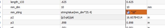

If you have an inch part file with a mm expression and format it to string, it converts it back to the part files units.
Ex: Metric Part file
Expr1 = 3 inches, format to string = "76.2"
Ex: Inch Part file
Expr1 = 3 mm, format to string = ".118"
I just want the number shown to to be converted to string, no unit conversion.
I've attached a couple of screen shots testing different ways to achieve this and so far nothing works.
Even if the numbers are unit-less (Constant) the behavior is the same.
Is there a way around this??
A way to force it in the "format" Expression itself???

You can do a math conversion on the value:
Cowski... delivers the elegance once again.
Thanks Man.
