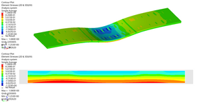

Hello,
I have modeled a foundation slab using solid elements and applied four vertical concentrated loads on top of it. As a result, I observe tensile stresses at the bottom of the slab and compressive stresses at the top.
Could someone advise me on how to convert these stresses into moments and if there is a normal force or not as they are vertical loads only? Should I consider each stress as a force and multiply it by the corresponding moment arm?
The photo below shows the stress at every node at mesh intersections.
Thank you for your assistance!

Probably the easiest solution is to remodel it with 2D plate elements - sometimes simple is best?
Do your solid elements provide Nodal forces? If so, that's the only way I can see to do it. Ideally, the software would have a way to get moments at specific cut lines through the solids.
Depending on what software you are using, of course. Maybe start with a forum that's specific to that software (if one exists). If not, tech support from the software.
Agree with JoshPlumSE. Most modern FEA softwares will have integrated tools that allow you to cut a plane through a group of nodes where it will integrate your stresses for you to produce a force.
If you know the stresses on the top and bottom surfaces and everything is elastic (linearly changing through thickness) then a simple summation and use of moment arms will do the trick.
