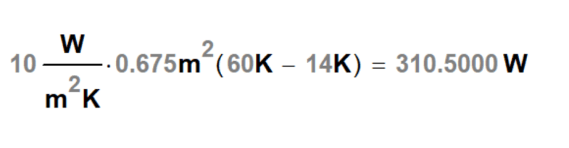

Hello I'm looking for advice on if I'm approaching this problem in the correct way whilst trying to keep it simple.
I'm designing a rectangular stainless steel cooling tank which will be located outside with no insulation.
I have 170kg/hr of water at 90°C entering a tank under gravity flow, I need the water leaving the tank to be less than 60°C (also under gravity flow).
I've made a guess on the dimensions of the tank to give a starting point to the calculations. Area of water in contact with the tank walls of 0.675m^2 and a wall thickness of 6mm
Outside mean average summer temperature 14°C
I've calculated the heat loss from the tanks walls:-
q = 15 W/mK x 0.675m^2 x [ (60°C - 14°C) / 0.006m ] = 77.6 kW
I've calculated the heat gain from the hot water entering:-
Q = 170kg/hr x 4190 J/Kg °C x (90°C - 60°C) = 5.9 kW
As the heat loss from the tank is more than the heat gain am I right in saying the temperature of water leaving the tank will be less than 60°C?
I know there's a lot of factors I haven't taken into consideration to try to keep it simple such as lower night temperatures, wind, heat from the sun (tank positioned in a shaded location)
I was also planning designing the tank with baffle plates to promote free mixing to help with the assumption that the contents of the tank will reach a temperature equilibrium.
Thanks in advance

Your calculation is flawed in that you only appear to be considering the heat transfer from inside the tank to outside the tank as though all that heat can be lost to the air. It can't.
Still air heat convective loss from a vertical plate is around 20-30 W/m2K. So assuming your surface area is the vertical section? then you're looking at approx 25 * 0.675 * (75-15) = ~ 1kW
So I think you will have water at about 85C exiting the tank.

Aside from the issues mentioned by others, your equation is for the thermal conduction of the wall, and not the convection from the wall; that's obvious from the inclusion of the wall thickness, which convection doesn't care about.
But, yes, the non-mixing of the tank contents means that there may be a huge amount of fluid that at a much higher temperature than desired. Using only the tank walls for heat transfer is not sufficient for proper cooling

However as others have mentioned but not clearly I believe, is that there are actually 3 heat transfer surfaces in series not one that you are using of the thickness of the plate, as the plate resistance to heat transfer is negligible. The three heat transfer sufaces are as follows:
Inside wall convection coefficient hi
Tank wall metal conduction coefficient k
Tank outside air film coefficient ho
k of the wall can be neglected likely since it is negligible compared to the other two
ho of the outside film is likely the largest and governing. For still air on a vertical surface ho = 1.47 BTU/hr/ sq ft-degF or the resistance R to heat flow is 1/U = 1/1.47 = 0.68.
Since overall U value is sum of 1/R where R is the resistance of each layer to heat transfer then total U is
U = 1/SUM(R) = 1/(1/hi + dx/k + 1/ho)
Without considering the other two resistances the outside film resistance of 1/1.47 = 0.68 will give an overall heat transfer coefficient of 1/0.68 = 1.47. I don't know what the inside film resistance of still water film on a vertical plate but there may be some information in heat transfer books, but I think it will also be significantly lower than the outside air film coefficient but maybe not negligible.
I believe the correct conversion of k = 15 w/m-K is 8 BTU/hr-ft-F. and with dx = .006 meters then dx = 0.0197 feet and then R = (dx/k) = 2.46E-3 for the plate. Plugging into the equation for U above and not considering the internal convection resistance hi:
U = 1/SUM R = 1/(1/1.47 + 2.46E-3) = 1/.6827 = 1.4647
(Where Q = UAdT)
So the change in overall U by including the resistance of the plate to resistance of outside film is negligible.

Fortunately, you're "only" trying to push 5.9 kW of heat out
Unfortunately, you need at on the order of 19 of these boxes to do the job, even when assuming 46C deltaT across every single thermal interface to the air on every single box. THAT is not going to happen, so you need to come up with a different cooling scheme, like maybe the cooling tower mentioned above. The bottom line is that you need somewhere between 20x to 30x increase in your heat transfer equation to get your heat flow out; that means a combination of improved heat transfer coefficient, as in forced convection, or massively more cooling area.
Below is my calculation of what your box might be able to do; it ignores anything going on inside the box, so that's where the upper bound is uncertain.
TTFN (ta ta for now)
A 3/8inch plain SS tubing may give you about 15w/m2/degK (rough indication - see table 5-2 for natural convection + radiation htc in Perry Chem Engg Handbook, 7th edn) based on external surface area, so that amounts to approx 4.7 x 15 x (75-25) = 3500w per 100m of linear length. For 5900w, that requires about 170m of total length. If you split this flow into 3 bits of 3/8inch tubing hooked up in parallel, total length for each = 55m. Flow is laminar so resistance hi will probably dampen this a bit, but this gives you a rough idea.
