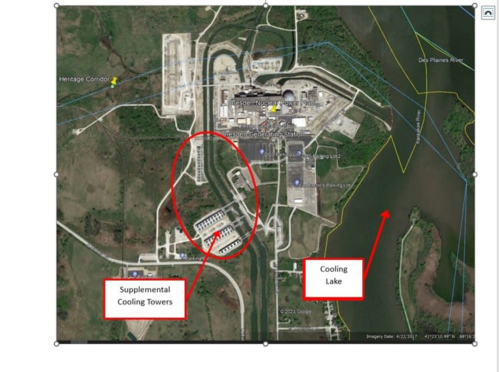

Cooling tower performance is tied to ambient wet bulb conditions (weather related). Higher wet bulb temperatures occur in the summer when higher ambient and relative humidity occurs. Initial system design and proper system maintenance are critical to be certain the cooling tower is providing the desired cooling.
The local power company here installed supplemental cooling towers that are only used on hot summer days so that they could generate more power on those hot days.
