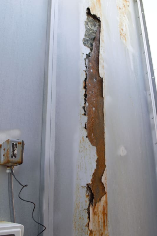

Here are some pictures of another cooling tower at another building. This one is even closer to the beach.
Photo 1

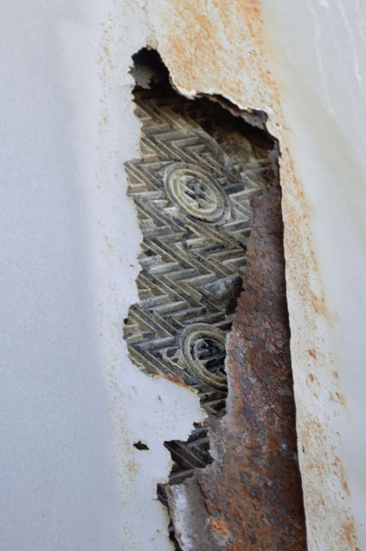

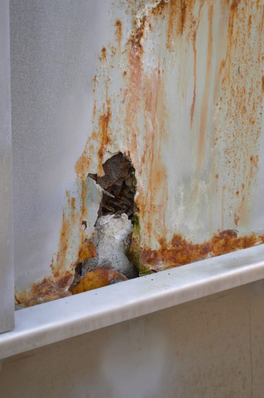

This one has a big hole on the side. In the picture above, there is a large streak of rust running vertically down the side. The hole below is in a similar position on the other side.
Photo 2
Photo 3 - Is this the fill where water trickles down?
Photo 4

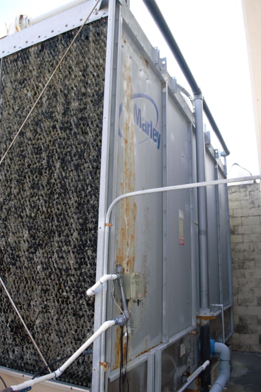

A look inside this tower
Photo 5
If the external feature where air enters is just a screen, this changes my outlook and recommendations on what to do with these cooling towers.

Looks very much like this is a Marley ( the clue is the painted name on the side of the unit) cross flow with what looks like an MBX or similar fill which is a drop in pre formed plate pack.
If I was you I would find a local Marley distributor and take their advice.

I now realise your second photo was a different cooler, but I still think they are cross flow units which appear to act more like a heat exchanger than a more traditional cooling tower.
