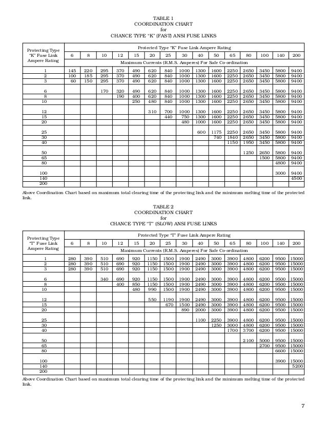

"Maximum clearing time of the protecting link is no greater than 75% of the minimum melting time of the protected link"
-Electrical Distribution System Protection by Cooper Power System
see fuse coordination table here: Link
A 80K fuse can coordinate with 50K fuse up to 1250A. The margin between these two fuse at 1250A is less than 50ms yet it coordinates. This works because the higher the current the faster the fuse link melts, fuse do not have a constant time to melt thus no need for a constant margin.
A recloser is different because regardless of fault current, it takes a constant amount of time for the switch contact mechanism to open, therefore you need a constant margin like 200ms between devices. As modern reclosers get better, you can definitely go under a bit. see specs from G&W viper recloser, they advertised total clearing time of 46ms
