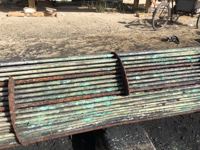

in my refinery we have naphtha cooler and facing problem for rapid corrosion and erosion and tubes leak. shell side is naphtha and tube side is seawater. tube side material is copper nickle alloy.
Naphtha inlet temperature is 320 F and out let is 100 F while seawater in let is 70-80 F and outlet is 130 F.
can any one explain main reason of high rate of corrosion and tube leak.

Copper Nickle either 70/30 or 90/10 is velocity sensitive. These are not very hard alloys.
There are published velocity limits, but be aware that even at the published limits the tubes are expected to erode.
Typically if they can keep the general wall loss down to 0.0005"/yr they consider it useful.
320F is getting rather hot for CuNi, and very hot for seawater cooling.
This will scale like crazy at 130F.
There are alloys that are much more erosion resistant, but you still need to address the scaling.

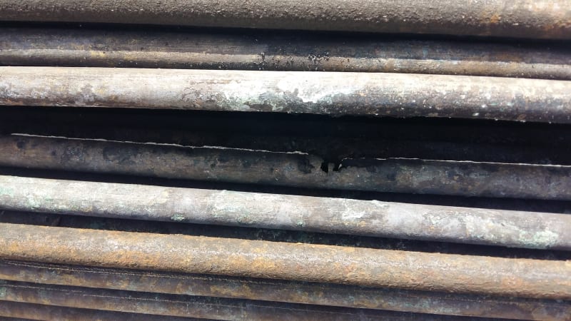

these photos are visual observation, today i will try to get more information then share with you guys for more discussions.
Regards
it seems like localized corrosion due to condensation. You must identify why in that specific places.
Collect deposits, corrosion products, clean damaged metallic surfaces to confirm/discard flow assisted corrosión or erosion.
Take a look inside the exchanger or in the surroundings for leaks or other sources of fluid taht could be the origin of the mechanism.

for your information this exchanger is condenser, Naphtha vapors are being cooled down in this exchanger, yes condensation is there as you said.
May be naphtha contain H2S and water vapor and while condensing this create localized corrosion.

This 60 year old heat exchanger is at the end of it's design life .... It must be replaced ... nothing lasts forever.
You seem have what is typical of most process plants .... all of the drawings are gone, no maintenance records exist and all of the nameplates/dataplates have been ripped off. Maintenance departments all over the world do this because it ensures that they will never have to work on the equipment (no information) and the problem then can be kicked downfield to the engineering consultant
I suggest that you hire a HX consultant and at least get the cost for a new TEMA AEP Seawater duty unit with an upgraded tube material. You will have to establish the necessary HX duty
I believe that you consider a slightly larger diameter replacement HX made from a superaustenitic SS, or perhaps titanium, or perhaps C276. A larger diameter/number of tubes will mitigate the erosion problem. A material upgrade will ensure corrosion.
Now, your MBA boss will tell you that he doesn't have enough money and scream at you that you "must come up with another plan !!!! "
His extensive background in taxes and accounting are no help to him here ...
Explain to him that the only alternative plan is to rebuild the bundle an be prepared to replace it every 3 years ...

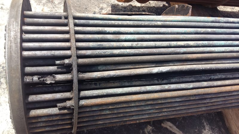

Yes, H2S will cause the passive film on Cu alloys to become very soluble leading to very rapid metal loss.
Read the Special Metals Monel handbook, the information is there.

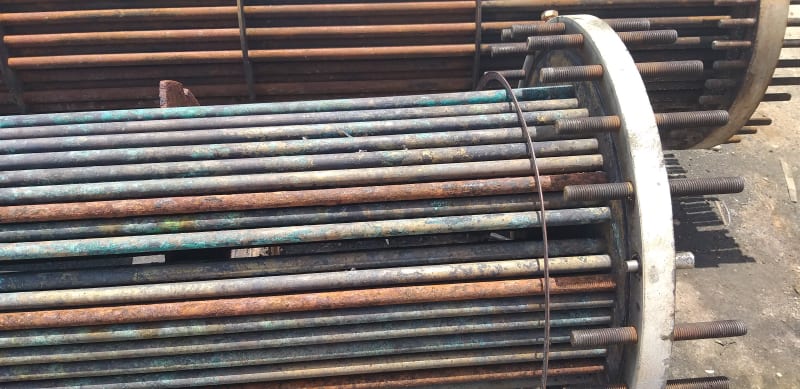

Here is two more picture for another exchanger for same service, E-103A, its type is TEMA R.
Hot inlet side have copper salt but outlet side no salts deposited.
