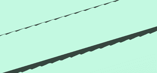

Every now and then I run across a part that gets corrupted graphics. This is on NX 11, linked with TC. All I can do right now is share screenshots of non-confidential bodies within this part. (Unfortunately I can't share the part itself because of company confidentiality... and when I make a copy of the part in order to remove confidential material, this bug goes away).
What I am showing here is a dummy part - there is a green tube, filled with red material, and a yellow film on the bottom: [Figure 1]

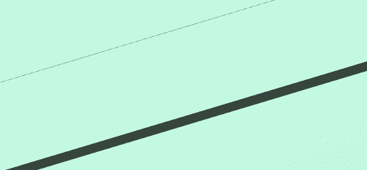

When the part is working correctly, it looks like this [Figure 2]

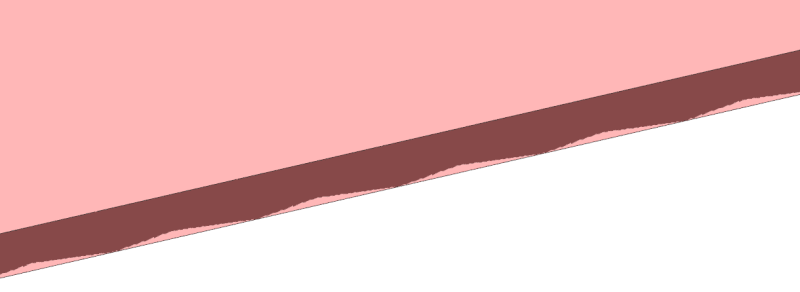

But sometimes after I do some work (most often after I invert show/hide, but also after other commands), the graphics get all all goofy - see [Figure 3] and [Figure 4]
When this happens, it affects the entire view - including all parts in the assembly. I can fix this graphics issue with Right Click...Replace View...Trimetric (or any view, actually). But this is just a temporary fix, and the graphics get corrupted again after a few minutes.
Has anyone seen this issue before? I also saw this at a previous company, I think we were running NX 10 (or maybe 10.5) at that point. Is there a way to fix it, or at least prevent it from happening?

No, it's not duplicate bodies. (For the dummy part I showed above, I made that fresh and it only has 3 bodies). Furthermore, when this graphics issue occurs, it affects the visual representation of all parts. Here's a snapshot of a single body elsewhere in the part, where the edge is all messed up:
And here's a screenshot of a rib from a single body, with and without the graphics issue:

Yes, that looks like exactly the same issue I have! Unfortunately, when I mess around with Advanced Studio, I don't get any popups at all! Messing around with the Advanced Studio options doesn't seem to fix anything for me.
When I invert show/hide, the issue shows up, but now I can at least fix it with a Fit command. That stays, but just until my next invert show/hide.
