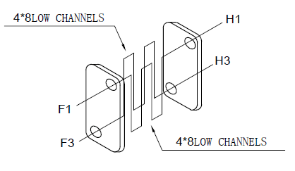

We currently use a plate heat exchanger that is designed as follows
F2 is the HOT INLET
H3 is the COLD INLET
We have a problem that we cannot attach elbows directly to each of the 4 ports as the gap between the centres on the ports is only 50mm
Our Heat Exchanger supplier has said we can get the same performance with the following design and it will solve the issue we are having with attaching elbows to each inlet/outlet:
In this design, they say:
F1 is the HOT INLET
F3 is the COLD INLET
I can see along each plate the flows are in the opposite direction to each other.
They say that the performance of both layouts is the same.
Can anyone let me know if this is true?
COLD temp is between 6-20C depending on the time of year
HOT temp is approx. 37C
The liquid is water flowing at about 6 litres per minute.
thank-you in advance

In the original design, the counter flow is from LEFT to RIGHT.
In the proposed design, the counter flor is from TOP to BOTTOM.
At those sorts of delta T the performance might be pretty close, but doesn't look right to me.
Plate HXs work as sets of plates adjacent to each other.
First one is a counter flow with hot and cold going from different sides.
Second one is concurrent flow with both flows going from left to right.

yes the second one is concurrent flow from right to left, but counter flow from top to bottom

Using your data sheet (word) I confirm that the counter current design will have outlet temperature of 8,03 C and 36.05 C but for the co current design you should have a temperature of 22 C both outlets.
The supplier should submit a formal calculation note to support the co current design.

Not that of course if the cold water side is up to 20C, then this will impact the two temperatures, probably changing them to 22 or 23C for counter current and ~28C for co current flow.
An approach temp of 2C looks quite low, but maybe correct for plate exchangers where the flow seems to be quite low for the surface area.
After querying it again the HX supplier said they made a mistake and the concurrent flow design is much lower performance.
