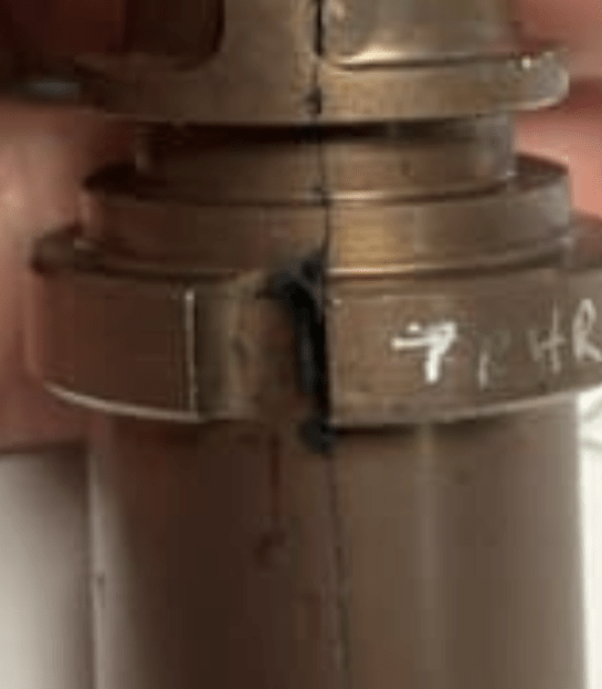

Hello All,
Looking for some advice. We make injection molds and have an issue where 420 hardened to 48-50RC is cracking in our material delivery systems.
Looking for a material with increased tensile and elongation at 120C with similar corrosion resistance.
Was thinking about using a precipitation hardening grade like 17-4
As always cost is a concern so this eliminates the maraging grades
Would appreciate any comments or recommendations.

Sorry i should have added more details.

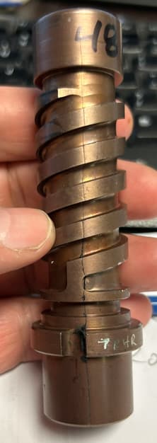

It is from mechanical failure. It is a nozzle that can see upwards of 30,000 psi in an orifice of 0.5" x 4" long
From a real estate perspective, it is not easy for us to change the design. We looking at this to increase the wall thickness by approx 15%
I think i really need a material with similar hardeness but increased ductility/elongation to avoid the stress cracking

We do plan to change the o-ring gland where we believe the cracking to be originating at. Other than that it is not possible to change the design as whatever we do must be backwards compatible with existing tooling in the field.

You may want to look at the geometry of this area. The notch cuts through the radius on the step and the notch appears to have unfinished edges. These may contribute as stress raisers.
I still think it is worthwhile to perform a metallurgical analysis to better understand. Break open the crack and look at morphology under the SEM to confirm it isn't fatigue, identify where the crack first began, and establish the type of fracture (i.e. transgranular vs. intergranular?). Also cross-section transversely through the fracture origin to establish whether secondary cracking is present and confirm microstructure consistent with specified heat treatment.
Given the hardness, is it possible that hydrogen embrittlement occurred through hydrogen pickup either during processing or subsequent service?
I agree with Mr Failure, Send the part out to a met lab to process a failure analysis.
now my educated guess we are looking at a heat treat crack.

o ya the way figure out if it is a heat treat crack when they section the pc if there is corrosion in the crack area, then yes it was initiated at heat treat. be sure to have every part before heat treat and after final inspection , a NDT of the part to verify it was free from cracks. then after so many hours of service yank it out and have it NDT .
if cracks present then could be due to incorrect heat treat, stress risers, wrong material for fit form or function.
