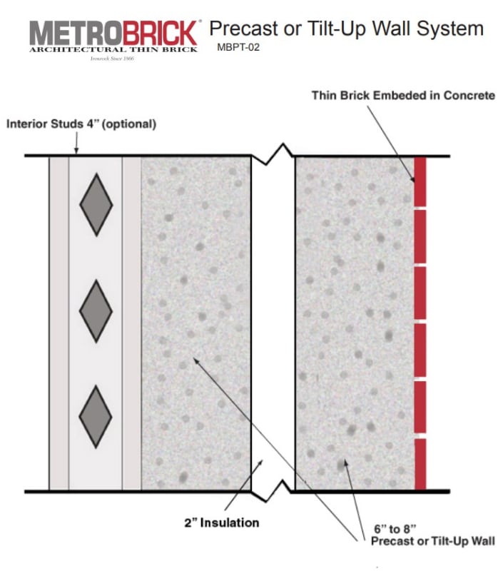

When you say "thin set" what is the actual wall section like? I would have thought the brick was cast into the face. However, I read your description as (moving inside to outside) 8" concrete + 2" insulation + 3/8" (?) mortar + 3-5/8" brick? How is the brick anchored to the panel?

Thanks for the Added info. I just want to clarify the wall section one more time (sorry). Is it like this at the sections where we see those cracks:

The wythe with the thin set brick is about 3". No interior studs at all as it is a gym.
