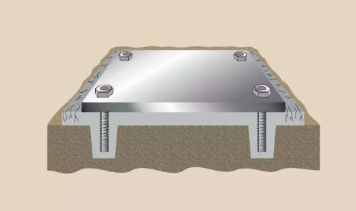

Are the cracks in the grout under this baseplate a concern?
It's a 10" x 10" x 1/2" steel baseplate. The column has a design load of 10 kips. This is residential construction.
I don't know what type of grout was used.
How thick is the grout there? If that's a 1/2" base plate we can barely see any of it so I'm assuming it's basically completely sunk in. The cracks at the edges look like spalling of the grout against the side of the base plate.
The total grout thickness is around 1" to 1.5", depending on the baseplate.
Yes, I believe it's a 1/2" thick baseplate, and it's basically sunk in to the grout (top of baseplate is almost flush with top of grout).
I would guess there's around 1/2" to 1" of grout below this baseplate.
Edit: Yes, the cracks are mostly on the side of the baseplate from what I can tell. I'm wondering if they might extend under it, but maybe it's just spalling on the top edges? This is my first time getting structural grout done. I wasn't expecting cracking, but maybe it's normal and expected when the base plate is sunk in like this?

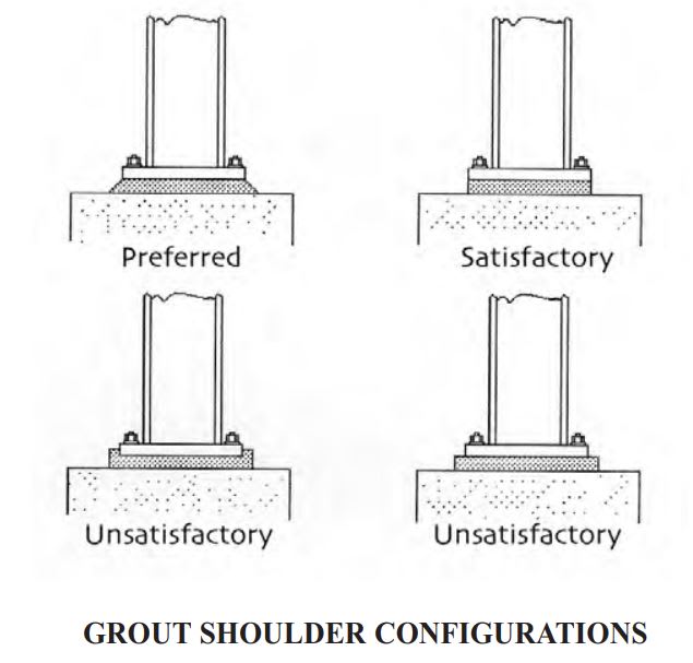

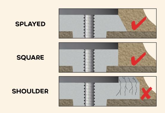

That's a great reference. Page 36 shows the exact situation -- grout poured above the bottom of the baseplate and left unchamfered ("Unsatisfactory"). It says this configuration will lead to cracks in the shoulders of the grout, which is what occurred in my baseplates.
Pages 35-36 also explain that it's usually not a structural concern: "Do not allow grout to remain above the bottom edge of the baseplate or in an unchamfered shoulder. In those locations, grout is prone to cracking because of differential expansion when the temperature changes... Shoulder cracks rarely propagate under the baseplate, and do not affect the vertical load-carrying capacity of the grout. For a cosmetic repair, coat the crack with a paste made from the grout and a little water."
If the grout were left exposed, I can see how the cracks would be a serviceability concern, or freeze-thaw concern if outdoors.
Since my baseplates are covered with a concrete slab, perhaps it's not a concern in my situation.
