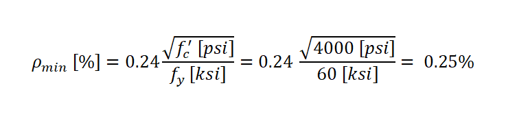

I did find FHWA Soil Nail Walls Reference Manual Link and it states min reinforcement ratio of - assuming 4,000 psi ocncrete and grade 60 rebar:
So as-designed #4@18" does NOT meet this minimum criteria.

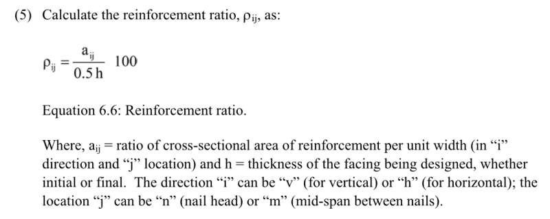

The FHWA Ref Manual states an interesting way of calculating reinforcement ratio, ρ, it uses half of the facing thickness, h, and not the gross area of concrete, as traditionally used by Codes and Standards for reinforced concrete min reinforcement requirements:
Does anyone know the background to using 0.5h?
