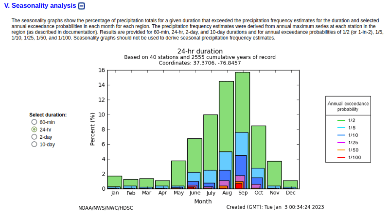

NOAA atlas 14 supplementary information tab has this graphic, and other information relevant to understanding the derivation of NOAA Atlas 14 data.
