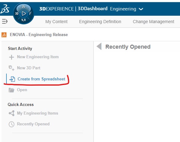

Azzazil said:
is this possible in 3DExperience?
This is from a post from ENOVIA community
Regards
Fernando
