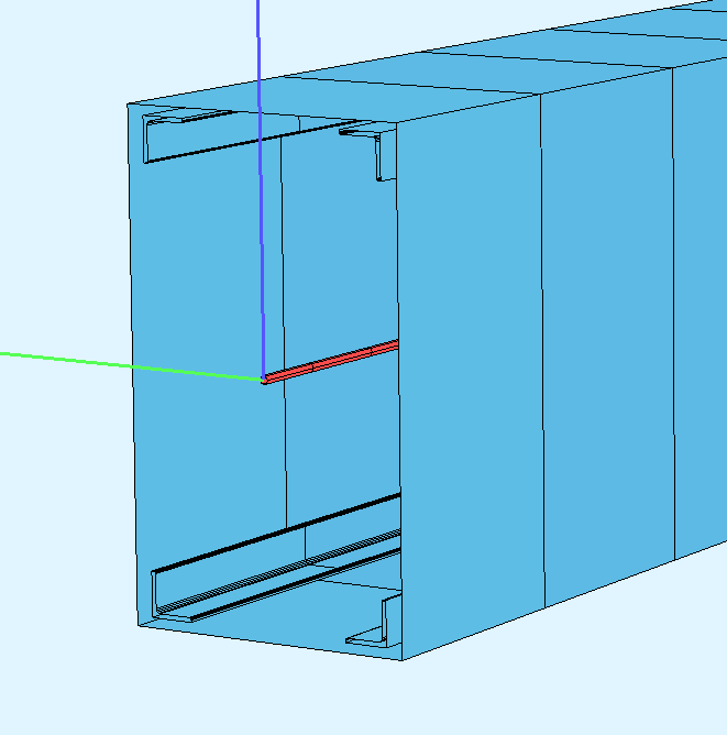

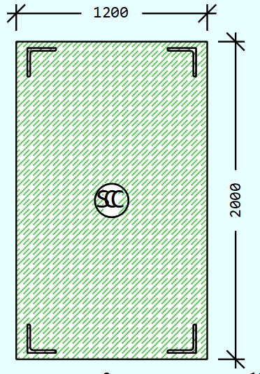

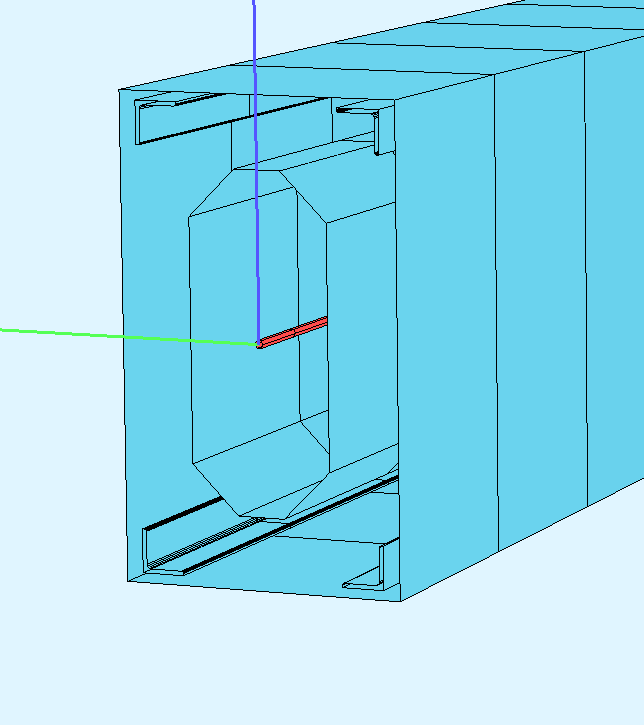

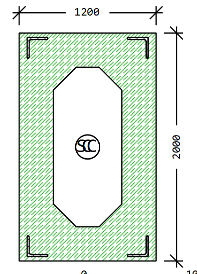

I use Sofistik to analyis a composite beam with tendon.
I have 2 beams that only cross sections are different, one is solid section, the other one is hollow section. Both beams have steel parts (4 legs), concrete and tendon.
Solid section

There are 4 construction stages
CS NO TYPE T TITL
10 G_1 0 ‘Steel Skeleton’
20 G_1 0 ‘Concrete’
30 C 10 ‘Creep + Shrinkage’
40 P 0 ‘Post-tensioning’
For solid section, the analysis is successful, but for hollow section, the analysis result will depend on the size of tendon duct.
The area of steel (4 legs) is about 24764mm2 according to Aqua. The equvalent diameter of the area is 0.25 x pi x dia^2 = 24764, dia = 177.6 mm
If tendon duct <= 177.6 mm, the analysis for hollow section is successful. If tendon duct > 177.6 mm (DO = 178), the analysis for hollow section is unsuccessful, it aborted at AQB CS 30 (Creep and Shrinkage), and show error message
the error message are:
I have several questions:
1. Why Sofistik consider tendon at CS 10, when only steel is activated? The tenon should be consider at CS 40.
2. Solid section has the same tendon as that of hollow section, but the analysis is always successful even if I use duct size = 500 mm for solid section.
