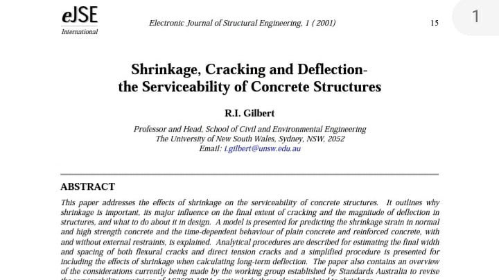

Normally we have been using 35% stiffness modifier for checking slab vertical deflection for Service load combination (DEAD+LIVE).
Would you use the creep coefficient along with reduced stiffness of slab and beam etc.? My creep coefficient is about 1.7.

I use Ian Gilbert's braking factor and effective stiffness. See sections 4.2 and 4.3 here:

The Gilbert method didn't make it into the Australian code. Its validity for design is based on the code allowing 'refined calculation' by other recognised methods. It's based on fundamental concrete behaviour so equally valid if designing to ACI's 'more comprehensive analysis' provisions.

Gilbert's books and papers on Long term effects cover general theory as well as ACI, Eurocode and Australian codes. The code part of it is really only material properties. Deflections do not work differently in ACI code countries!
