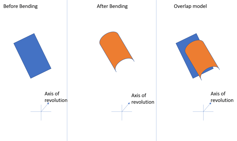

I have a Creo parametric model, Which I am converting to NX parametric model. I had an issue while converting toroidal bend feature in Creo to NX.
In Creo, Toroidal bend feature was created using flowing parameters.
As you see in the above picture, Rectangle was bent about an axis (used as BEND AXIS in Toroidal bend feature) which is not passing thru the absolute coordinate system.
on the right side of picture you can see the output of toroidal bend feature( "Preserve length in angular direction" option in Toroidal feature dialog is turned on so the distance from points on the curves to the plane of the profile section is maintained along the angular direction).

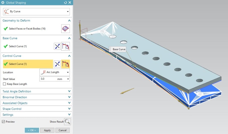

To reproduce this in NX, I tried to use Global shaping by curves feature. But I was not able to understand how to create Base curve and control curve to replicate this geometry.

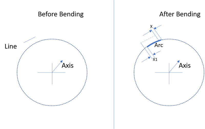

As you see in the above image if I have a straight line and Bent it about an axis Toroidal bend option is doing following things.
1) Converting line into arc (if it is a spline then Creo is using some different method and calculating creating new spline).
2) Moving end points of line to new location(If it is a surface then Creo is also scaling geometry).
I want to replicate same behavior in NX 12. Could you please help me with this.

I only have a 2d surface not a solid, As per above picture if I take rectangle and bent about an axis it is giving new geometry as per the center image.
Could you please let me know how I can do this?

OK, I have understand with the video. Find below the explanation of base curve and find attached an example
I hope this help
Regards
Didier Psaltopoulos
Hello Didier Psaltopoulos,
Thanks for the reply. I tried to define straight line (created line at the top of rectangle) as a base curve and arc (whose center is passing thru the datum axis) as a control curve. But that didn't give the results as expected. As per as I understand Global shaping by curves calculate the difference between two curve equations and bend the geometry. In Creo, only Profile, datum axis and coordinate system are given as input and output geometry is scaled and type of curves are also changed. I am not able to understand how to create a Base and control geometry which gives this output.
Thanks,
Krishna.
just try and try and try...
But maybe it's just one simple thing: You should use option "Keep Base Length" in Control Curve group.
There is also a lot of freedom for definition of the start point.
Base and Control Geometry is defined in Didiers example in Sketch (3): a straight line as Base and the Arc as Control.
