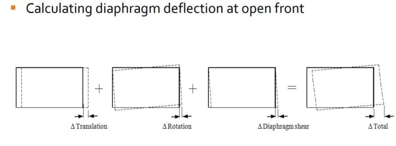

Ev11, have you looked at providing bracing on the sides and rear of the retail store? ie a 3-sided box. This could be an option and you just need to check that the additional twist from an eccentric wind won't deform the front glazed side enough to damage the glass.
If you need a bit more bracing stiffness on the front glazed wall, you could go with what you've shown in your sketch. Essentially you're bridging the gap between the bottom of the diagonal bracing and the foundation via bending within the SHS columns. You then get a push/pull in the lower portions of the columns too. If you do up a quick analysis model you'll see this behaviour.

Many engineers, including me, will be of the opinion that you ought to include your moment frame even if you do the three sided building thing. More so if this is in a high seismic region (not in most areas of Ontario). The three sided building business is a legit technique in terms of equilibrium but it asks a lot of:
1) the diaphragm
2) the diaphragm fastening
3) the diaphragm boundary elements
4) your diaphragm analysis accurately capturing displacement at the open side of the building and the impact that will have on the global, P-Delta demand generated by your gravity columns moving through that displacement.
Anecdotally, these things have a disproportionate habit of racking over during serious seismic events.
Lastly, unless I miss my mark, your diaphragm aspect ratio is likely not favorable for this (1:1-sih). Depending on the deck material, seismicity, and governing code, an aspect ratio like this will often either be disallowed or punished as an extreme torsional irregularity.

Is it correct to assume that, in your world, the bracing mentioned in bolded font above would actually be true diaphragm bracing in the sense that it is:
1) Discrete horizontal bracing using rods, cables, angles etc and;
2) Not just a bare steel deck diaphragm performing the bracing function without discrete bracing as is common in North America?
That is my understanding of AU practice based on the Aussie traffic that I've seen here. I like three sided buildings a whole lot better when the diaphragms are discretely braced.
Yes Kootk the horizontal bracing system is invariably rods/struts/rafters. The sheeting is generally considered a bonus, even though in reality it probably does the grunt work.
Yeah, I kinda wish that we'd taken that approach. Cat's out of the bag and down the street now though.
