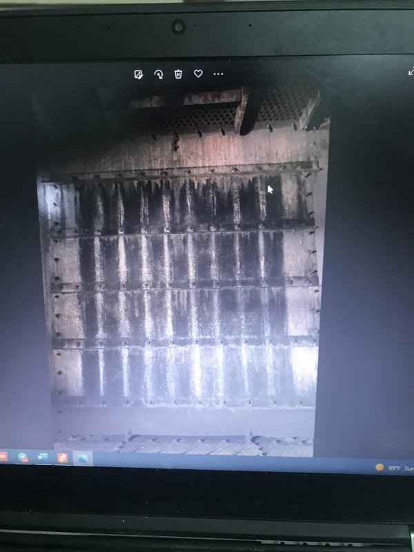

Crude Distillation tower
It's some sort of grill / very large grate.
Are we looking up, down, sideways?
where in the tower is it - can you mark up a drawing?
Is it just to stop someone falling down the tower?
Here it is for everyone else.
Could it be a tray downcomer? I'm assuming the photograph shows a side view/elevation view, not a top/bottom view.
-Christine
Demister?
Viewing the attachment of the post, on top of the grate I see a fine mesh screen for the purpose of which I have no idea.
Top of the picture is a perforated plate with Flat Bar supports, that looks like it might be perpendicular to the internal of interest. I do not see the vessel shell anywhere in the picture, so that does not help referencing the orientation.

My guess is this is the lower half of a liquid distributor assembly - the upper half, which consists of the liquid feed pipe and distribution fingers, probably disassembled / removed.
It looks like the place were enters the feeding line of the column but a more detailled foto is required for an accurate answer.
