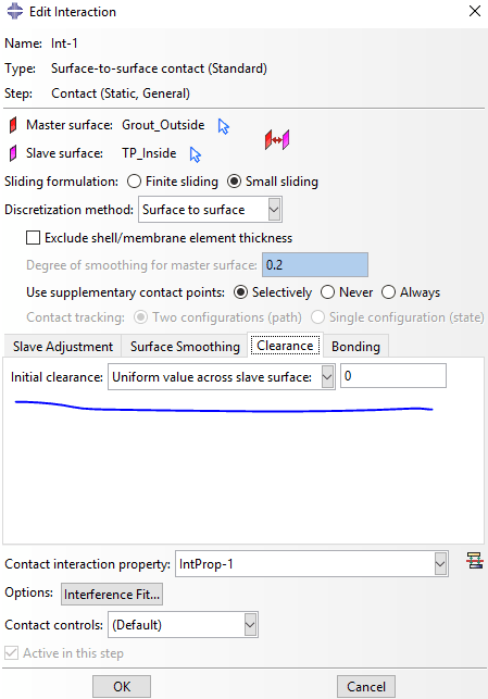

Pretty much all nodes seem to be open, I tried to fix this by setting sliding formulation to "small sliding" and uniform value across slave surface to zero. Shouldn't all nodes be closed? Or atleast sliding? Is there something I am misunderstanding, and how can I fix this? I know a finer mesh helps with this, but the improvement was minimal when I tried.

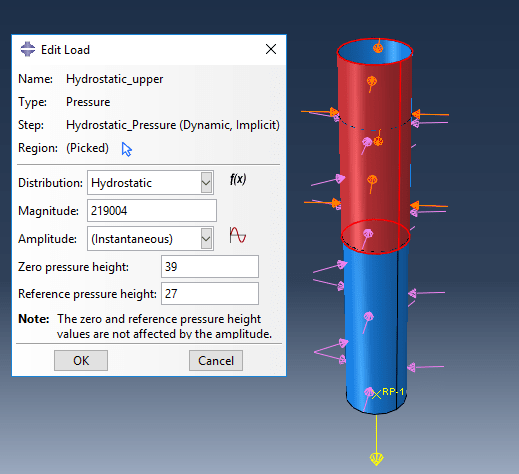

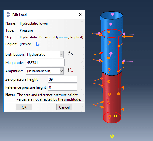

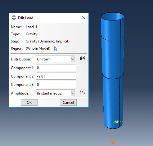

Its all solid C3D8R elements, I am applying self weight and hydrostatic pressure. The first step (after initial), is to make contact. Then I apply self-weight, and finally hydrostatic pressure.

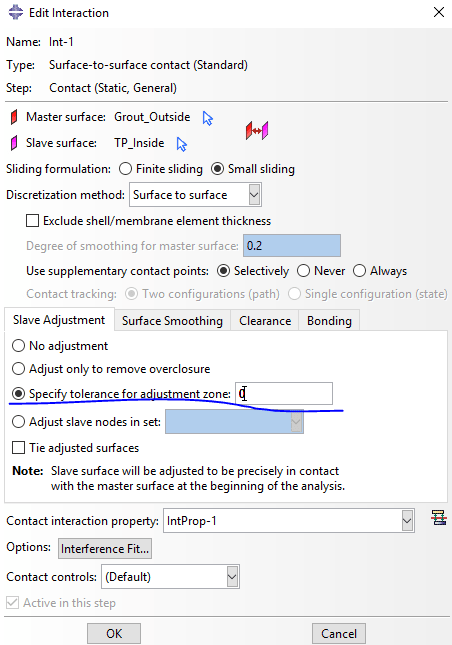

Yes, adjustment tolerance is very important. Deafult value of this parameter may not be enough. In such case you can specify it manually. It should be approximately equal to the distance between surfaces (be careful here not to use too large value or it will move more nodes than necessary).
Keep in mind that this is strain-free adjustment. If you want to include the strain resulting from adjustment in results, use interference fit.
So as I understand it, I have to adjust this parameter to be the distance between surfaces (which I believe is 0, so that there is no gap between the parts):
As this is not enough to cause zero gap between parts:
When I try to run the inp file, I get the error "The volume of 140 elements is zero, small, or negative. Check coordinates or node numbering, or modify the mesh seed. In the case of a tetrahedron this error may indicate that all nodes are located very nearly in a plane. The elements have been identified in element set ErrElemVolSmallNegZero."
So as I understand it I need to refine my mesh at the point where this error occurs - I was thinking of having a finer mesh at the contact surfaces? Is this worth trying out, have a rough mesh, but fine where contact occurs. I still would like to keep element type C3D8R, but if I were to change what would be worth trying?
This tolerance value is the maximum distance from master surface at which Abaqus searches for slave nodes (and adjusts those that were found so that they are in contact with master surface). Small/negative/zero volume error in this case means that Abaqus found nodes that shouldn't be adjusted because their adjustment results in high distortion of corresponding elements.

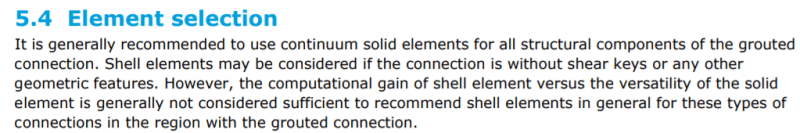

I was thinking of shell elements aswell, but it is recommended using brick shaped 3D continuum elements to the largest extent possible:
I also need to model what is referred to as "shear keys" in the paper, meaning I cannot proceed with shell elements. If the extra fine mesh at contact surfaces isn't enough to fix the problem, is there anything else I could look into?
Make sure there’s no overclosure between the contacting parts (it seems that there might be some overclosure in your model). It should be possible to adapt the adjustment in such way that it works correctly.
Thank you FEA way, just last questions for today;
- How do I go about fixing the overclosure problem? (Just where to start)
- Do you think it would work to have finer mesh where parts connect?
- Should I mainly focus on the slave adjustments?
In case of overclosures you can use the option named "Adjust only to remove overclosure". It can be found in the same place as adjustment tolerance setting.
Refined mesh should help but most likely it won’t be sufficient.
Right, if there are no overclusures, focus on adjustment tolerance.
Ah okay, I did try the "Adjust only to remove overclosure" and still got the same error. I will keep trying, thank you for the help.
